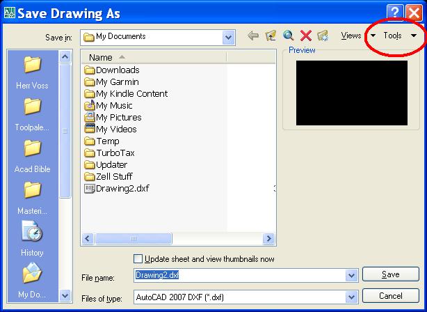

If you're asking how to export selected entities instead of the entire drawing...
Start the Saveas command
Select DXF as the file type
Select Tools (upper right corner)

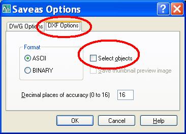

Select Options > DXF Options > Select objects
You'll be able to select the objects you want to export
