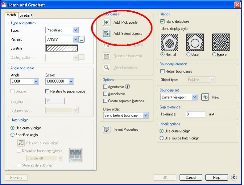

qball
Pick Points? I'm not sure I understand.
I don't want to select hatch areas with pick points. I want to pre-select object before typing "h" - "enter"
like so:
I selected some rectangles, circles, etc, typed HATCH, if "OK" is greyed out it means that Pick Points is on, so click Select Objects (it should select your objects you already picked) and the OK button should be available.

jrn
like so:
Hmm, not really.
My hatch menu is only shown as part of the ribbon.
By the way. My PICKFIRST is set to 1

irneb
I think what qball has shown is the full hatch command - which only shows up if your ribbon is closed. Which I think is a bit silly, some of the options are "easier" to get at using the dialog - wish I could find a sysvar similar to the LayerDlgMode. Anyhow, the same thing applies with the hatch command when you've got the ribbon open as does with the command-line version -HATCH.
  1. Select the object(s) which will form the border
  2. Click the Hatch button on (Ribbon: Home / Draw), or through the menu: Draw / Hatch, or the draw toolbar (if you have it open), or simply type H.
  3. Now the ribbon opens, either type S or click the Select button in the Boundaries panel of the Hatch Creation ribbon (which should have opened instead of the dialog).
  4. Type P to "re-select" the object(s) you just had selected.
  5. Continue with the hatch as usual (change the settings if needed or simply Enter / Space to apply if already correct from last time).
