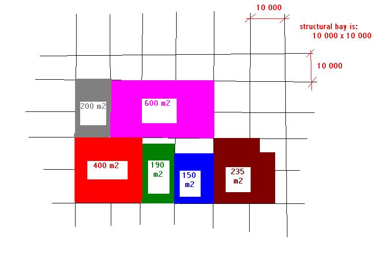

CAD-LOVER0208 Posted September 21, 2008 Author Posted September 21, 2008 hello, thanks for the reply.. I actually sketched it but not to scale.. but in CAD i can't get the shape and the right size to make it fit in my property.. we have specific areas limit.. 8640 m2... so that's why i'm trying to figure out each area, which is in m2 and i have to change it to mm then figure out the area. that is no problem, but as i said how to get the length and width of that m2... i know Dave said i can't do that... I tried to scan my sketch but my scanner was acting crazy, anyways i also tried to work with paint program and i made a simple drawing just to show u what i mean... i did them by eye and by the structural bay width and length.. 10 000 mm = 10 m Quote
dbroada Posted September 21, 2008 Posted September 21, 2008 OK, that's a start. It looks like you have 2 rows, each 20m high so you can work out the widths from that. As you have shown, your 400m^2 is 20m x 20m. Your 190m^2 can then become 190/20 = 9,5m (or 9500mm) etc. The AutoCAD command I would use is RECTANGLE and draw each box in turn. The move them using ENDPOINT OSNAPs and you should be able to arrange a plan. Quote

CAD-LOVER0208 Posted September 22, 2008 Author Posted September 22, 2008 Thanks Dave and Tiger. your ways helped a lot.. i'm just playing now with the shapes to fit them in the right area we've been asked to have. and thank you RichterGMC for the link, it's just GREAT, everything i need it's IN THERE... i love it... thanks all again i'm still working on my plan... Take care.. Quote
