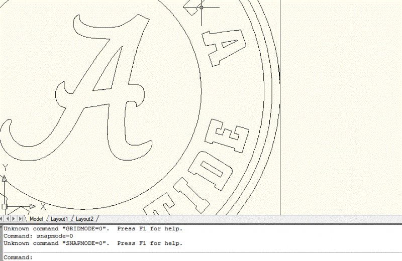

Explode didn't seem to help my problem. I did notice that I have a grid system of dots that my mouse pointer likes to snap to even with object snap off. Inside the picture the mouse pointer goes away and I have to guess when I get close to a line to alter it. Outside the image the mouse pointer appears but only wants to snap to the grid points.
Sounds like you have grid on and snap mode on. GRIDMODE=0 and/or SNAPMODE=0
Unfortunately that didn't seem to help either. Can I upload the dxf file here to let somebody else see if they have the same problem?

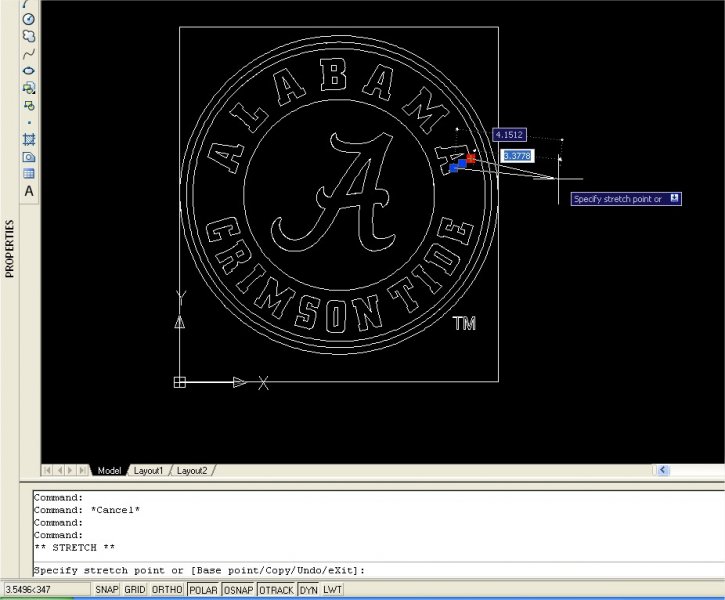

Everything works great with the logo for me. You did have Grid On and Snap On. I can also select each line of the logo. See below:
There's plenty of clean up to do on this logo as well. You have lines on top of lines (which means it won't plot very well). And your circles are made up of very small lines. Shouldn't take you too long, though.
