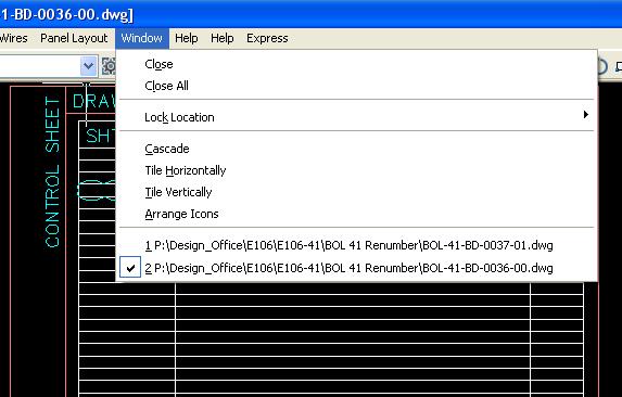

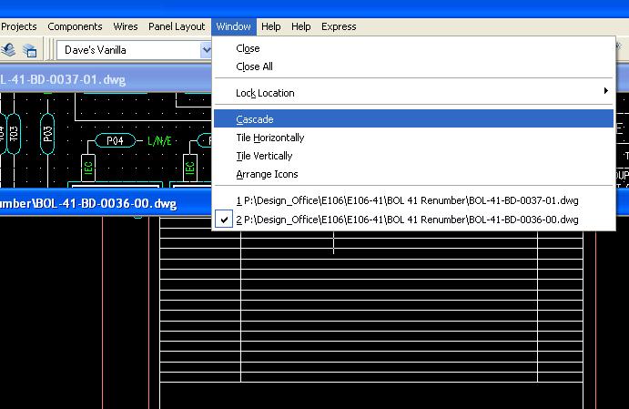

khoshravan
maybe we mean different things. I use the windows menu to swap...
[ATTACH]27609[/ATTACH]
or
[ATTACH]27610[/ATTACH]
These images are what I am looking for. Could you please tell where can I find "window" command in AutoCAD 2010? Previously I used AutoCAD 2007 and "window" was there on top but in A2010, the ribbon has changed everything I can't find it.

ReMark
That looks like AutoCAD Electrical. Is it?

ReMark
If you want to view a list of drawings you now have to look under the Menu Browser which is the big red letter "A" in the upper left-hand corner of your screen. AutoDesk refers to the drawings as Recent Documents.
I think I found what you are looking for.
You need to have the Menu Bar showing. The pull-down menu called "Window" is included on it.
There should be a drop-down arrow on the right end of the Quick Access Toolbar to the right of the Menu Browser. Click on the arrow. At the fly-out menu find and click on the option Show Menu Bar. This will display the Menu Bar above the Ribbon.

khoshravan
Dear ReMark
Thanks a lot. You solved my problem. I was unaware of that tiny flesh near the quick lunch.
