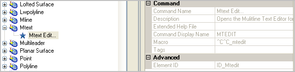

Here's a snapshot of my Double Click Action from the CUI:
... Which is not editable, as it (ACAD.cui) is loaded as a partial in my enterprise CUI, and I'm the only person with write-access on the server - and I haven't changed the CUI for a while.

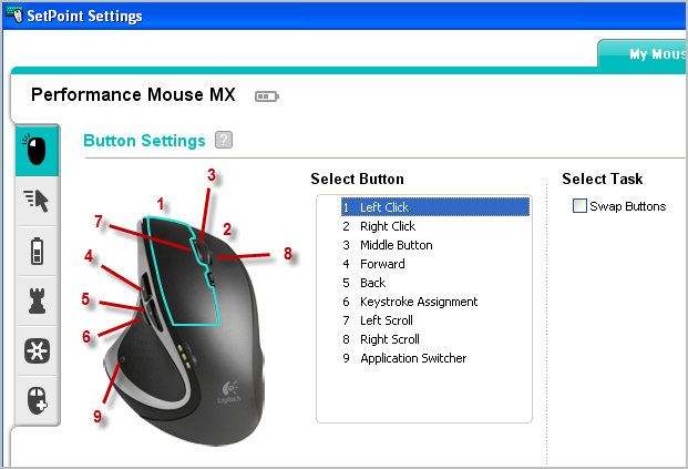

BlackBox
Just a shot in the dark here...did you check your mouse and/or mouse settings?
If that is the cause, I am unsure as to how, never mind that no equipment changes have been made (i.e., hardware, settings, etc.):
I've been using this mouse for a year +/-:

nestly
Doesn't the Enterprise CUI load first, followed by the Main CUI, followed by any partials? What I'm getting at is your Doubleclick options shouldn't be greyed out in the CUI that's actually controlling your Double-click actions.
Share this post
Link to post
BlackBox
Here's our CUI structure in a nutshell:
The Main CUI is editible to the user, and is stored on their personal network space for customization.
The Enterprise CUI is not editible to the user, and is store on the network (myself, and a few others have write-access to this netowkr drive only).
ACAD.cui is loaded as a partial to the Enterprise CUI (and has been for nearly two years without issue).
The only CUI file with Double Click Actions is ACAD.cui, neither the Main, nor Enterprise have any.
I have tried copying the Double Click Action for Mtext to the Main cui with no change in behavior.
To reiterate, I have also changed the current profile to the OOTB profile, where ACAD.cui is the Main CUI - no change.

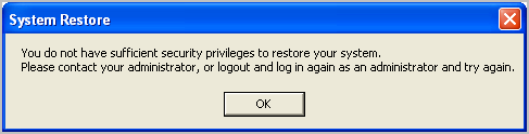

Do you have a Restore point?
Share this post
Link to post
BlackBox
Hmmmmm... checking now.... :unsure:
Share this post
Link to post
BlackBox
That'd be a "Negative" on my end:
I'll have to contact IT.
Also, never had to do a repair before, is that something that requires IT typically (I assume)?
