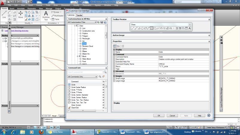

khoshravan Posted June 19, 2011 Posted June 19, 2011 (edited) I did as mentioned in tip (attached photo shows the place I inserted *) But it doesn't repeat the circle command. sth must be wrong. I am using ACAD2010. Edited December 8, 2011 by khoshravan change photo Quote
Ahankhah Posted June 20, 2011 Posted June 20, 2011 1- I guess you pressed Escape key when the macro was working. Don't use escape since it aborts the macro. 2- I think you attached the picture several times. You can erase duplicates by pressing Edit Post and following the instructions. Yashasin Gozal Tabrizimiz Quote

Ahankhah Posted December 9, 2011 Posted December 9, 2011 Try REPEAT instead of * ^C^Crepeat circle Quote

Ahankhah Posted December 9, 2011 Posted December 9, 2011 I made a mistake in the name of command. Indeed it is MULTIPLE. ^C^C_multiple _circle Also this macro must be absolutely correct: *^C^C_circle Should you write what is the result of selecting the menu item with preceding * in its macro? Quote
