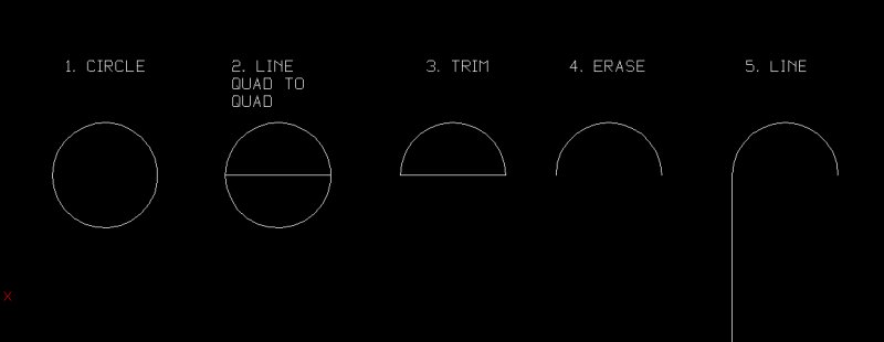

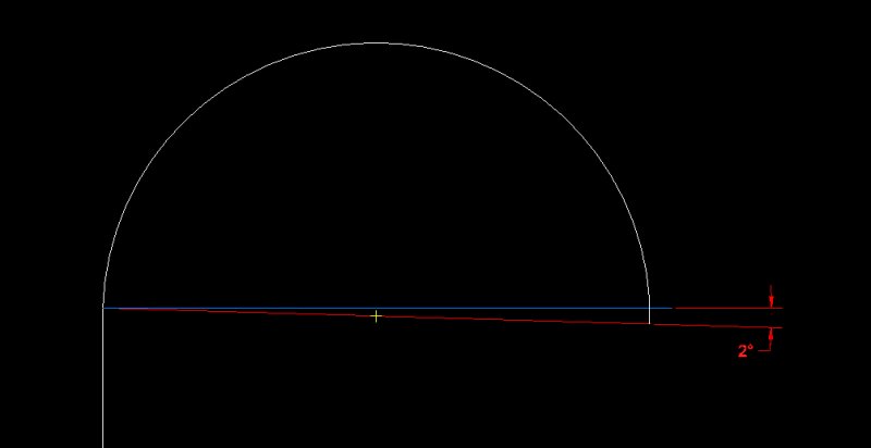

Jack_O'neill Posted August 6, 2011 Share Posted August 6, 2011 That is very much improved. You'll get a much better extrude on this path. I did notice however, that the arc is rotated 2 degrees around its center point. Was that intentional? In the pic below, the blue line is perpendicular to the white vertical line you drew. The red line runs between the endpoints of your arc. That's fine if that's what you meant to do I was just curious. Quote Link to comment Share on other sites More sharing options...
SFG13 Posted August 6, 2011 Author Share Posted August 6, 2011 Hi Jack, I just got mixed up with the arc rotating around in circles and trying to make it stay put in it's standard position, which wasn't intentional. What command or tool do you use to see if it's correct or not like with the one you attached showing the red and blue line? I'll try to redo it. Thanks "That is very much improved. You'll get a much better extrude on this path. I did notice however, that the arc is rotated 2 degrees around its center point. Was that intentional? In the pic below, the blue line is perpendicular to the white vertical line you drew. The red line runs between the endpoints of your arc. That's fine if that's what you meant to do I was just curious" Quote Link to comment Share on other sites More sharing options...
ReMark Posted August 7, 2011 Share Posted August 7, 2011 SFG13: If arcs give you too much of a problem you can always use a circle and a couple of lines to trim it with. You'll have better control of the angle at which the resultant arc is cut. Do you know how to do this? Quote Link to comment Share on other sites More sharing options...
Jack_O'neill Posted August 7, 2011 Share Posted August 7, 2011 Sorry, I was gone all day again yesterday, and will be out most of today too. Try this: You can do every bit of this with ORTHO turned on, and everything will come out straight and lined up like it should. Quote Link to comment Share on other sites More sharing options...
SFG13 Posted August 8, 2011 Author Share Posted August 8, 2011 Hi Jack and ReMark, Oh man you guys are right, I didn't realize that, circle, halfway line left and right, select, trim, arc! Thanks a lot for the tip! Quote Link to comment Share on other sites More sharing options...

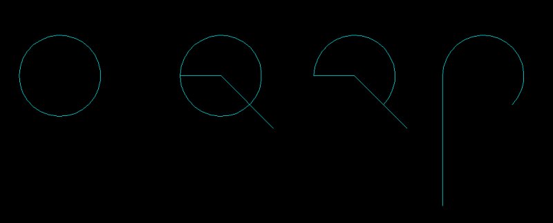

Jack_O'neill Posted August 8, 2011 Share Posted August 8, 2011 If you want to have the handle wrap around a little more than just the half circle, you can use the same methods as above, slightly modified as in this picture. Just draw the line from the quadrant to the center, then off at any angle you wish (you'll need to turn ortho off to do the angled bit). Then just trim and erase as before, add the long line and there you go. Quote Link to comment Share on other sites More sharing options...
