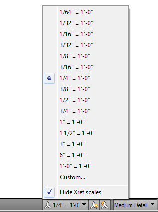

tzframpton Posted September 10, 2011 Posted September 10, 2011 What Dimension Style are you using? Sounds to me like an Annotative problem to me. Make sure the Annotative dimension style is selected first. Next, look at the bottom right of your interface you have the Current Annotation Scale list. (See Image) Change this to a more appropriate scale and see if this helps. Quote
