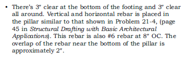

ReMark Posted September 11, 2012 Share Posted September 11, 2012 (edited) Here is what it says in my copy of the instructions for Plate 2 regarding rebar in the "pillar" (I call it a pier). Regarding the metal siding (a.k.a. - decking). There is no mention whether this is attached vertically or horizontally. My guess would be that vertical is the way to go based on what we do here at our chemical plant with corrugated metal siding. On page 13 of the instructions it says only four specific items must be labeled in Plate 2. Only the footings, columns and roofline are to be designated by hidden lines according to the instructions. Use hatching to show the siding only in small patches is another recommendation. Edited September 11, 2012 by ReMark Quote Link to comment Share on other sites More sharing options...

warpath37 Posted September 12, 2012 Share Posted September 12, 2012 no i have not tried that approach as far as talking to someone from PF but I will give it a shot. the rebar: in your drawing it has the rebar bending at the bottom the opposite way that the book shows it, the book has them facing each other with a couple of inches overlapping. what does it mean by 'overlap' at the bottom of the pillar? and the 2" clear on the side on yours, where the horizontal rebar meets the vertical piece how far past the vertical rebar is the horizontal piece supposed to extend? Quote Link to comment Share on other sites More sharing options...
ReMark Posted September 12, 2012 Share Posted September 12, 2012 I assume that you are referring to the image I included in post #81. Do NOT use that as a guide. Each situation calls for a different approach. In the example provided some of the rebar will be installed when the pile cap is poured. This will be allowed to cure for 28 days. The contractor will return and form up the pier and place the remainder of the rebar after which the pier will be poured. The 2" called for in the above detail is to make sure the rebar is sufficiently covered by concrete. The horizontal rebar, when installed in the field, will extend just far enough that the steelworker has the ability to tie-off the two overlapping pieces with wire. This holds the position of the rebar when the concrete is poured. In a drawing of this type it isn't really necessary to show that overlap but I do. The contractor is familiar enough with this type of work to know what is required and will order the rebar properly sized for length. Quote Link to comment Share on other sites More sharing options...
warpath37 Posted September 12, 2012 Share Posted September 12, 2012 ok got it. The place I work wanted us to build concrete ramps to our steel building for the forklift to use and they tied the ends of the rebar how you described, so i understand what you mean now. now whats the last line of the directions mean exactly " the overlap of the rebar near the bottom of the pillar is approximately 2" " ? I am working on the other defects of my drawing and hopefully soon will be able to post an updated link. thanks again! Quote Link to comment Share on other sites More sharing options...
ReMark Posted September 12, 2012 Share Posted September 12, 2012 I assume that you have two pieces of rebar that will basically pass each other by. Each bar will overlap the other by 2". I'm not on my CAD computer at the moment so I cannot provide an image. Quote Link to comment Share on other sites More sharing options...
warpath37 Posted September 12, 2012 Share Posted September 12, 2012 alright that makes sense with what they show in their example. sorry that its taking me a while to understand all of this. bear with me lol Quote Link to comment Share on other sites More sharing options...
ReMark Posted September 12, 2012 Share Posted September 12, 2012 Hang in there...it will all make sense eventually. Quote Link to comment Share on other sites More sharing options...
