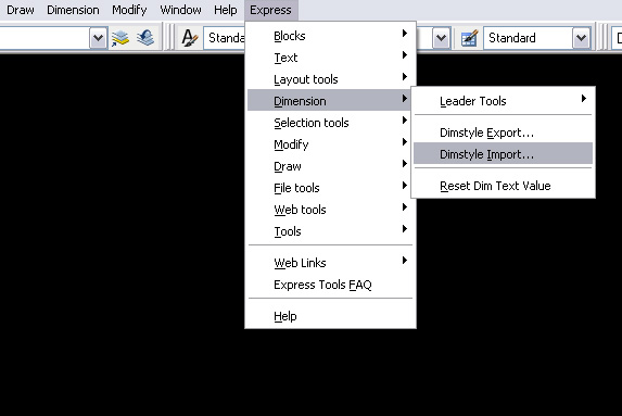

If you have access to a drawing created by someone else you can use the Dimstyle Export command found under Express Tools > Dimensions. There is also a Dimstyle Import command as well.
Do you have Express Tools installed?
You can also drag and drop dimension styles from one drawing to another using Design Center.
Express Tools > Dimensions > Dimstyle Import.
