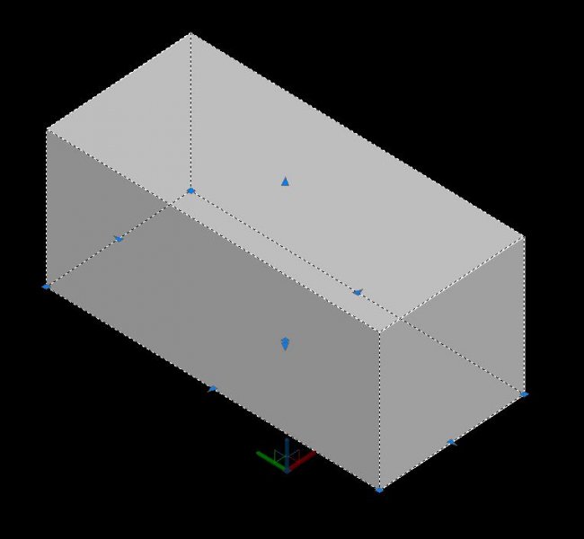

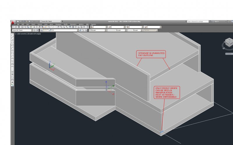

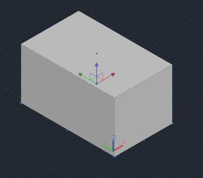

Randolph Posted March 7, 2012 Share Posted March 7, 2012 (edited) Hi there, I'm working with 2012 for the first time. I'm modeling a rough mass model of a building made of boxes for walls, floor and so on. As I'm used to, when in Visual Style 'Wireframe' I click on a box and get to see 4 quadradric and 4 triangular grips on the base of the box plus 1 on top to change the height. This is as it always was. NOW if I change to Visual Style 'Realistic', the grips on the back side are hidden behind the box as well as behind other boxes. Only the grips in front will be visible. No way to get a grip on a box on a side where it touches another. Even more puzzling is the behaviour of the grips in Visual Style 'X-Ray': the grips will show, but cannot be touched. Instead, an object in front might be selected. What can I do to make the grips work the old fashioned way - that is that they will be visible and 'manipulateable' on selected objects in all shade modes? Tune Log.txt Edited March 7, 2012 by Randolph Screenshot added Quote Link to comment Share on other sites More sharing options...

Randolph Posted March 14, 2012 Author Share Posted March 14, 2012 Hi Dadgad, sorry, that was not the solution. C'mon folks, no-one else an idea? This is what it should look like (screenshot from ACAD 2009): above And this is what it actually looks like (screenshot 2012): below Quote Link to comment Share on other sites More sharing options...

SEANT Posted March 14, 2012 Share Posted March 14, 2012 Maybe: Command: _cullingobj Enter new value for CULLINGOBJ : 0 Quote Link to comment Share on other sites More sharing options...
Randolph Posted March 14, 2012 Author Share Posted March 14, 2012 SEANT, I love you! You made my day! I remember you helping me a lot already ... How come you know things like these? Do you also know where this variable is set in the UI? I did not find it in the options window so far ... Remark ... you know, I had that idea before. But with hundreds of boxes, it's helpful to work in shaded mode. Quote Link to comment Share on other sites More sharing options...
rkent Posted March 14, 2012 Share Posted March 14, 2012 Do you also know where this variable is set in the UI? I did not find it in the options window so far ... On the 3D Modeling workspace, Home, Selection (to the right side). Quote Link to comment Share on other sites More sharing options...
