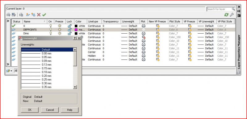

Using Autocad 2000LT with Windows XP and would like to make some lines in the drawing wider and or bolder. Read the help area in the program but it wasn't very specific on just how to make certain lines wider so they would stand out from the rest of the drawing. Help would be most appreciated
By opening your LAYER PROPERTIES MANAGER you can set the LINEWEIGHT of each layer, as shown in the image.

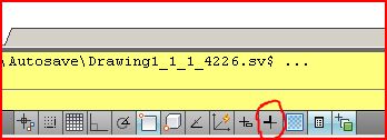

You can also turn on SHOW LINEWEIGHTs at the bottom of your screen in the status toggles area. When it is turned on, your different lineweights will be displayed as you are working on the drawing, I believe most users find this to be a bit of a distraction, and would leave it turned off.
Lineweight can also be addressed via your CTB or STB.

The easiest way is to designate certain colors to certain widths, be consistent with this in the whole drawing, and than use Plot Styles, as ReMark suggested.

Maybe you want to use polylines with its width?
