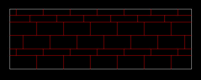

Hi, I need to create a hatch pattern for a flooring tile that we have currently starting using and I am having real issues getting it to work!:x!
The pattern is meant to be tiles set in a brick type style but with a rolling offset, but the tiles are different sizes - I have one row of 300x600, then a second row of 148 x 600, then another row of 300x600, then another 300x600, then a row of 148x 600, followed by another 148x600. This is the pattern end and needs to repeat itself. I have attached a line drawing of what it needs to look like.
I can get a very basic line drawing showing 300mm and 148mm for the first two lines but then it all goes wrong!:cry:
Any help would be greatly appreciated as it is driving me mad!!!!!

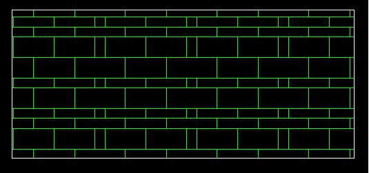

I would comment that the pattern does not seem to be repeating symmetrically. What happens at the top boundary? Do the bottom two lines repeat at the edge? Perhaps a hatch is not possible :unsure:
Maybe something simple like that...

Try this pattern of staggered tiles of varying heights - if the verticals aren't exactly where you want them then adjust their x co-ordinates (second value on each line commencing with 90,... or -90,...)

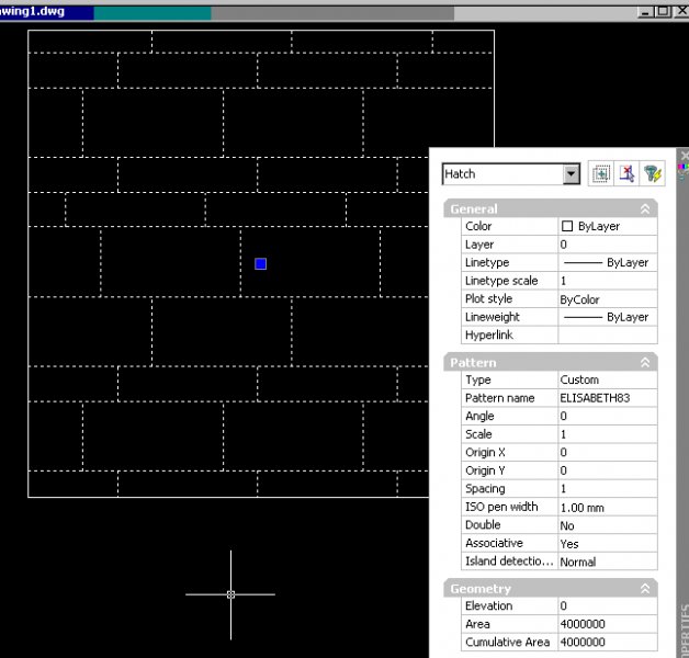

The pattern I posted works fine at 1:1 scale. Here's a 2000mmx2000mm patch hatched with it:

OK. If everybody wants 1:1 scale HYG:
*ELISABETH83,Elisabeth's Fooring
0, 0,0, 0,1344
0, 0,148, 0,1344
0, 0,296, 0,1344
0, 0,596, 0,1344
0, 0,744, 0,1344
0, 0,1044, 0,1344
90, 0,0, 0,600, 148,-1196
90, 300,148, 0,600, 148,-1196
90, 150,296, 0,600, 300,-1044
90, 300,596, 0,600, 148,-1196
90, 450,744, 0,600, 300,-1044
90, 150,1044, 0,600, 300,-1044
