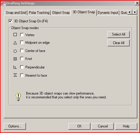

In 2012 and 2013 you have available 3D Object snaps.
