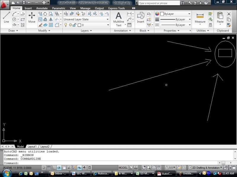

Autocad 2010, when I open it, it appears no ribbon? please see this:
How can I relaunch the ribbon. I do not know how come in the way. I closed it yesterday, but when I open it this morning, the ribbon didn't appear.
Please help.
in the bottom RH corner is a box that says "2D Draughting & Annotation". Change this to another option and see if the ribbon comes back.
Thanks for your quick reply. I'll try. thanks
Wow, it helps. thanks a lot. :)

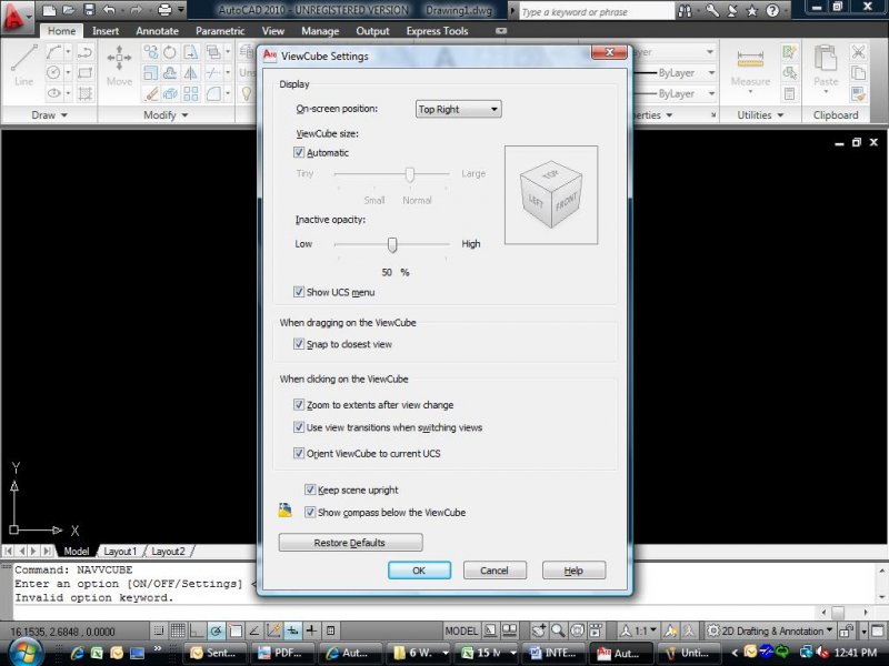

dbroada, I can't see the 3d box at the right right side. Where can I find it and put it back on its original place?
Please see:
Sorry, that is outside of my memory. I turned it off once as it got in the way and have never missed it.
Ok, no problem. Thanks.
command: NAVVCUBE , settings ON or OFF.
Tiger, I've tried that but nothing happen. The window apper, and then I clicked the restore default at the bottom and then ok, but. the box did not appear.

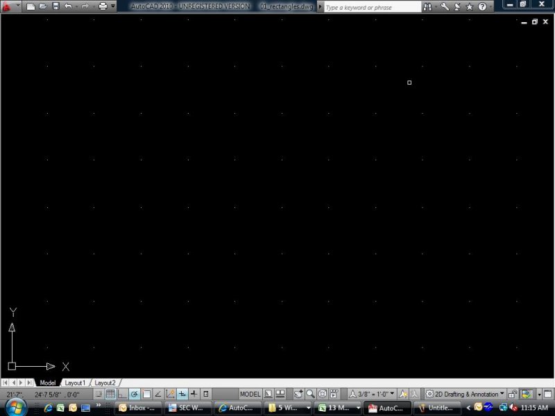

please see:
Try the command NAVBAR and set that to ON, does it change anything?
"NAVBAR" unknown command. Still nothing happen.

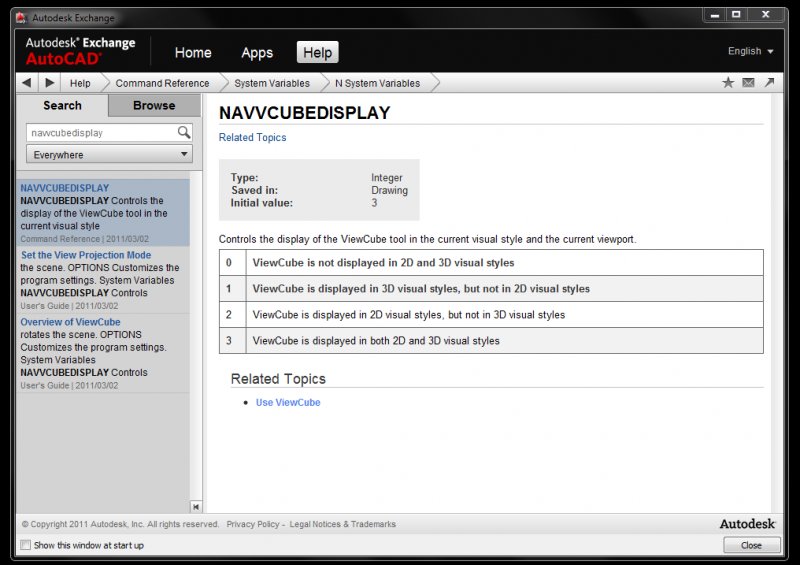

Also OPTIONS>3D Modeling
[ATTACH=CONFIG]35557[/ATTACH]
