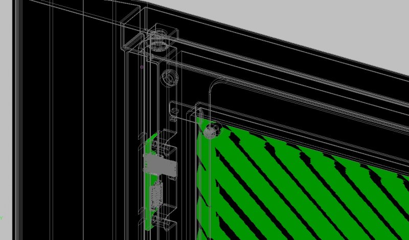

I'm having major issues with 3D in Autocad 2008. I do not know what to do to fix this issue. I have messed around with some of the settings and updated my video drivers but my models still look like crap. I'm posting in hopes that someone will have some good suggestions on how to fix this. I have a major project due soon and what you see in the picture below is how I have been working I can not take it anymore! Please HELP!

One thing worth mentioning is, If I copy and paste my model to a new file it looks fine until I make a handful of edits then it starts to look like the image I posted again.

One thing does pop out at me. You have an computer that is running Windows XP Pro 32-bit but you have 8GB of RAM installed? Is that right? If so what tweaks did you make to the system so it would recognize the additional RAM over 4GB?
The machine does not recognize the additional 4Gig of memory. We originally planned on running WIN 7 X64, but had a lot of compatibility issues with our vinyl printers so were running WIN XP.

The nVidia 600 is really considered an entry level graphics card although it does support OpenGL 4.0 and DirectX11.
Do you have hardware acceleration enabled or disabled?

I can't find the option to enable or disable hardware acceleration. so i'm not sure.

Re: hardware acceleration. 3DCONFIG > Manual tune > at top of Manual Performance Tuning window.
Re: slow. Since, in theory, a 32-bit computer can only address, without some tweaking, 4GB (more like 3.2GB actual) RAM could the additional 4GB of RAM be hindering performance? Could test that theory simply by pulling out two sticks and see what happens.
Hmmmmm......obviously I missed an important piece of information. You have two 4GB modules as opposed to four 2GB modules. So pull one stick of RAM out and see what happens.
