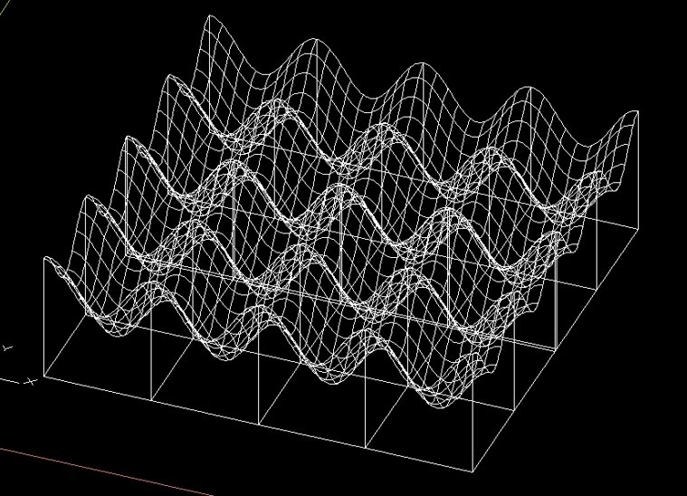

Hi I created a 3D math surface using 3DPLOT. However my outcome is a polyface mesh and I need to convert it to a solid. I have already tried the "Convert to Solid" & "Convert to Surface" options in the Mesh tab but I get "Mesh not converted because it is not closed or it self-intersects." I also tried the f2s.lsp but I am unsure on how to select my object.
Here is my object:
https://www.yousendit.com/dl?phi_action=app/orchestrateDownload&rurl=https%253A%252F%252Fwww.yousendit.com%252Ftransfer.php%253Faction%253Dbatch_download%2526batch_id%253DQlVqaUNIQzN3TGhvZE1UQw
It is basically a 3D plot of cos(x) + cos(y).

Perhaps the sine waves can be plotted as splines, then lofted. That surface can be used to slice a 3DSolid.
Here is a quick trial; not an exact match but pretty close.
SineConstruction.dwg
SineSolid_Inserts.zip

If you look in the SineConstruction drawing you will see the curves I used for lofting on ConstrGeom layer. That geometry already existed from a previous project - I just scaled it manually to get a visual match of your mesh geometry. The curves were originally computed via Excel to match an amplitude of 1 and a period of PI. Excel could just as easily created any custom amplitude and/or period required.
With the lofted surface I sliced an appropriately sized 3DSolid block. I used Block References to keep the file size down, but the process can be modified to get a solid of arbitrary size - either by boolean union or multiple period curves.

Here are some unit blocks for the 3d waveforms. I include one extra as I’m not exactly surewhat constitutes the overall amplitude when dealing with these 3d Surface/Solid constructs.
The blocks can be arrayed, then “UNION”ed together to one large solid. SLICE the edges to achieve final shape.

It depends on what is considered the amplitude. For instance, here is the largest with 3 possible amplitudes shown.
Each of the solids has an amplitude that is a factor of 2 to its neighbor. Choose which solids to keep based on your definition of amplitude.
You would create the array by copying (or via the ARRAY command) to the size you need. You would then UNION the solids, to form the sloid the size you need. If you need the waveform to start at a different position you may have to add an additional row in the array, UNION, then slice to the correct Start/End location.Array.jpg
