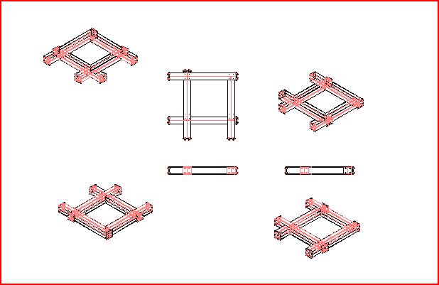

Dadgad Posted July 4, 2012 Posted July 4, 2012 thanks for the welcome and the rapid reply, i haven't used viewbase what is its function? is it similar to the sol commands?. These took me about a minute to do with VIEWBASE. I have always been a big fan of SOLPROF, and yes this is meant to be an easy and quick way to generate any of your standard 10 perspectives (6 orthogonal and 4 isometric) of a 3D object in modelspace. Lots of options, sections and details included. No viewports required. Images are generated in paperspace. As JD very rightly points out they are ASSOCIATIVE, and self updating. This sort of function is old school for Inventor, but new to Autocad in 2012, and enhanced in 2013. Should you wish to import an INVENTOR model you would have even more representational options available in the command than with a lowly Autocad model. Quote
