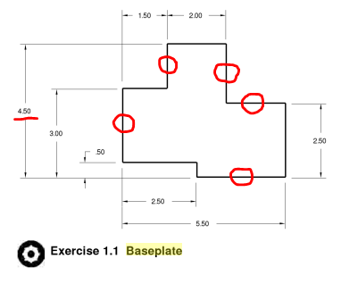

ReMark Posted September 13, 2012 Share Posted September 13, 2012 (edited) The OP states in post #36: "I try do the 1.1 baseplate but i little confuse with the numbers can you help me?" The OP states in post #38: "No i confused with the numbers to do the lines 1 big line is 4.50 i need find just the top what calc i need do." Unless I am reading this wrong it seems to me that frederico is having a problem with his math (i.e. - he cannot figure out the missing dimensions). Do you agree JDM? The exercise in question here and the one frederico refers to as the "1 big line is 4.50" is this: The 4.50 is on the left. The student is required to calculate the other dimensions. As I have already stated, I provided all but one of the dimensions in a previous post. All frederico had to do was jot down the missing numbers or follow my detailed instructions to create the baseplate. How much easier could it be? Edited September 13, 2012 by ReMark Quote Link to comment Share on other sites More sharing options...
ReMark Posted September 13, 2012 Share Posted September 13, 2012 (edited) frederico: Regarding the calculation we need to do in Exercise 1.1 it is 4.50 minus 3.00 = 1.50. You might want to look at post #15 as previously suggested. You'll find it contains additional dimensions. Aren't we fast approaching the deadline for the submission of this assignment? Edited September 13, 2012 by ReMark Quote Link to comment Share on other sites More sharing options...
fredericofrg Posted September 13, 2012 Author Share Posted September 13, 2012 frederico: Regarding the calculation we need to do in Exercise 1.1 it is 4.50 minus 3.00 = 1.50. You might want to look at post #15 as previously suggested. You'll find it contains additional dimensions. Oh now i saw i minus 4.50-3.50. Aren't we fast approaching the deadline for the submission of this assignment? : Yes dont remind me this because have 2 more assignment to do in Autocad. I go get Lunch now and back to try do again. Quote Link to comment Share on other sites More sharing options...

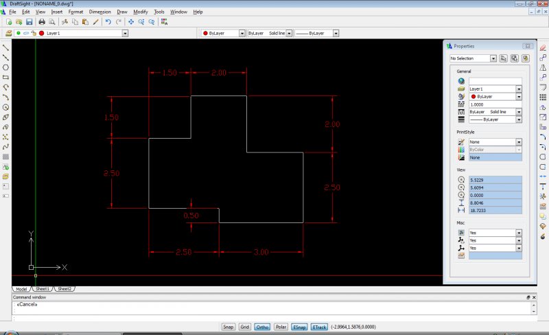

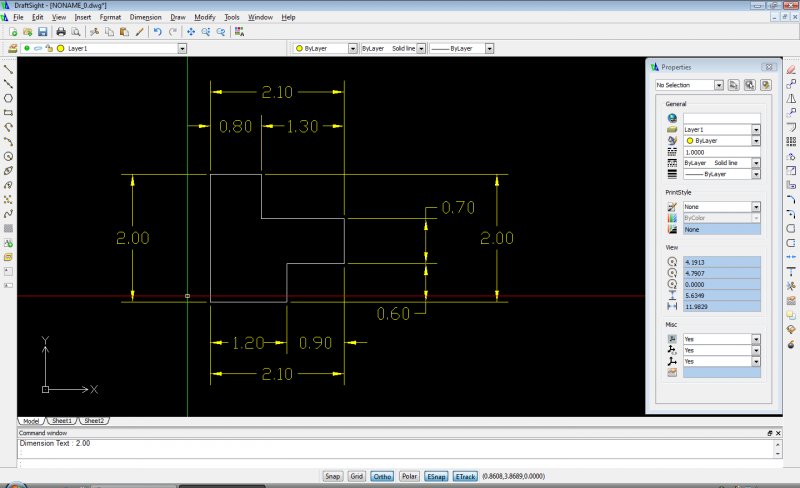

fredericofrg Posted September 14, 2012 Author Share Posted September 14, 2012 Is correct the 1.1 and 1.2 now? : 1.1 1.2 How can i modify to put the Values and not modify my project i just cannot see what i draw. Quote Link to comment Share on other sites More sharing options...

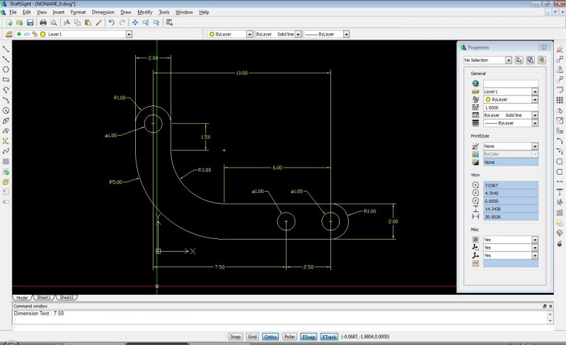

fredericofrg Posted September 14, 2012 Author Share Posted September 14, 2012 Ok i try do the 1.11 Bracket with the Fillet tool just put lines and try and specify r and the radius but i need 3XO1.00 is 3 yes? how can creat the circle with the correct O? and i need put lines in the middle of the circle? how can create the 2 lines in the middle to do the correct Radius in the lines with Fillet here is my Image: Quote Link to comment Share on other sites More sharing options...
ReMark Posted September 14, 2012 Share Posted September 14, 2012 On quick glance none of your drawings are correct. It seems you ignored every one of my posts regarding how to do each exercise. For example, in Exercise 1.1, the 3.00 dimension is wrong as well as the 0.50 dimension at the top. See post #15 of this thread for the correct dimensions. In Exercise 1.2 you ask "How can i modify to put the Values and not modify my project i just cannot see what i draw." I can only assume you want to override the dimensions AutoCAD is showing. Can that be done? The answer is "Yes". Would that make the drawing correct? The answer is "No". See post #16 of this thread for the correct dimensions. Re: Exercise 1.11 you have the wrong diameter on all your circles and your arcs too. I specifically mentioned in my post about this exercise that the original diagram was incorrect as it pertains to the radius 0.50 and 0.30. The radii should have been 5.00 and 3.00 so the bracket would end up looking like the original diagram. See post #26 of this thread to see how this exercise is done. Note the size of the circles and arcs that I used. Compare my drawing to the original diagram. All the answers to creating these exercises are contained within this thread that you started. Please, go back and look at them. Have a piece of paper and a pencil by your computer when you do. Make a quick hand sketch, copy the dimensions that I have provided and note any values for arcs and circles. You do realize that in some places, in each of your drawings, you completely ignore the dimensions given in the Google book reference you included in your very first post? Have you spoken to your instructor and told him/her that you are having problems? Have you asked another classmate for help? Quote Link to comment Share on other sites More sharing options...
ReMark Posted September 14, 2012 Share Posted September 14, 2012 Exercise 1.1 Maybe this will help. The baseplate drawing fully dimensioned. Quote Link to comment Share on other sites More sharing options...

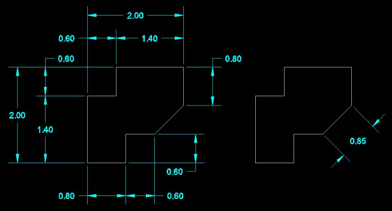

ReMark Posted September 14, 2012 Share Posted September 14, 2012 Exercise 1.2 Not only fully dimensioned but I added overall dimensions at the top and both sides. What do these dimensions tell us? Quote Link to comment Share on other sites More sharing options...

JD Mather Posted September 14, 2012 Share Posted September 14, 2012 Is correct the 1.1 and 1.2 now?.... What standard is the class using? I recommended to you that you attach dwg files here - not pictures. ANSI/ASME y14.41 (American National Standards Institute/American Society of Mechanical Engineers) standards call for 1/8 text height, suppress leading zeros and you have too many decimal places. Most parts are not manufactured to 4 decimal places - typical only for bearing fits and other close tolerance needs. In my experience out on the shop floor less than 10% of machinists can reliably measure to 4 decimal places. Only the best (usually in the grinding department) work on assignments to that tolerance. You are missing gaps between extension lines and object lines in at least a couple of locations. If you had attached your dwg files I could red-line so that you know exactly what to correct. Quote Link to comment Share on other sites More sharing options...

ReMark Posted September 14, 2012 Share Posted September 14, 2012 (edited) Ok i try do the 1.11 Bracket with the Fillet tool just put lines and try and specify r and the radius but i need 3XO1.00 is 3 yes? 3XO1.00 refers to diameter not radius. Yes, the 3X means that there are three holes all with the same diameter. The FILLET command has an option for Radius. If you haven't used it at all in your drawing the default setting is "0". That is why the corner appears unchanged. To apply a curve one must type "R" for "Radius" then input the desired value. After doing so AutoCAD will ask you to pick the first object (pick a line) then ask you to pick a second object (pick the other line). Make sure your picks are close to the intersection. The size of the three circles you are asked to draw is shown as a diameter and not as a radius. Do you know the difference between the two? how can creat the circle with the correct O? To create a circle with the correct diameter start the CIRCLE command and pick where you want the center point to be on your screen. STOP. Look at your command line. AutoCAD prompts: Specify radius of circle or [Diameter]: Type the letter "D" for "Diameter, input the correct value then press the ENTER key. and i need put lines in the middle of the circle? No. My guess is those lines are the "mark" symbol AutoCAD will add automatically when you use the Dimension > Diameter command. how can create the 2 lines in the middle to do the correct Radius in the lines with Fillet here is my Image: Haven't I covered this already? Your previous image. Note that you have used the wrong radius for the arcs at both ends and you have used the wrong diameter for all three circles. These values were called out quite clearly in the book. If you aren't going to follow the diagram what's the sense in doing the exercise? I assume your instructor is looking for an exact reproduction of each object as depicted in the book right? BTW...the three circles are located on the centerlines of the object. Two of the circles (the ones at each end) share the same center point as the arcs do. You should have no problem defining the center of each circle if you use OSnaps > Center when making your picks. Edited September 14, 2012 by ReMark Quote Link to comment Share on other sites More sharing options...
