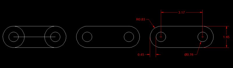

JD Mather Posted September 16, 2012 Share Posted September 16, 2012 Refer to redline image Smaller dimensions should be placed inside larger dimensions. First dimension should be about 3/8" (10mm) from object line, then about 1/4" (6mm) from previous dimensions. (see the book for the dimension placement) Leading zeros should be suppressed on inch drawings (but not on metric drawings). Extension lines should not lay on top of object lines. Your hole circle appears to be on your dimensions layer. I would place centermarks (perhaps by diameter dimension) and dimension to centermark rather than hole center for better looking drawing. Quote Link to comment Share on other sites More sharing options...
fredericofrg Posted September 16, 2012 Author Share Posted September 16, 2012 ok thanks i already found how to do ^^ just need think a little ok now i need think to do the other circle. ok more one ready: Quote Link to comment Share on other sites More sharing options...

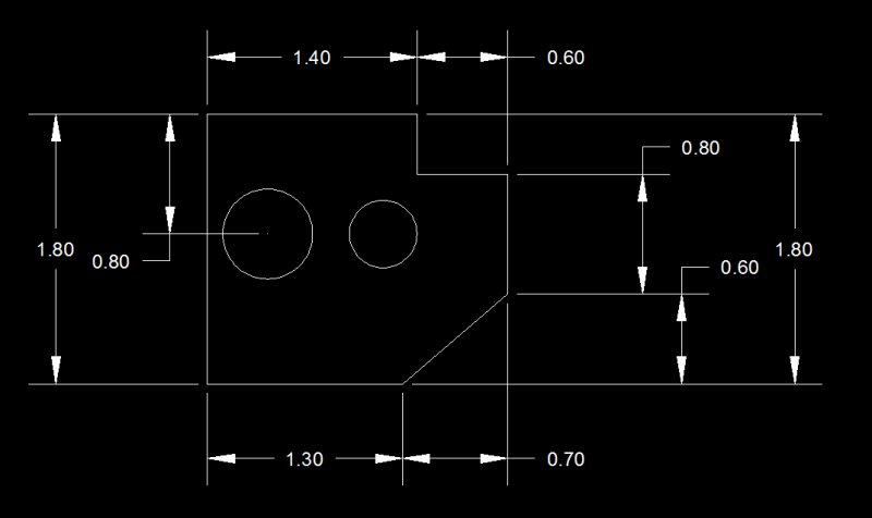

fredericofrg Posted September 16, 2012 Author Share Posted September 16, 2012 [ATTACH=CONFIG]37236[/ATTACH]Exercise 1.5 fully dimensioned. OFFSET used to locate center points of both circles. Notice the "aligned" dimension on the portion of the object that is drawn at an angle. Can you give me the distance and the lines i need move to create the base for after this create the circle or teach me how you find the distance? thanks. Quote Link to comment Share on other sites More sharing options...
ReMark Posted September 16, 2012 Share Posted September 16, 2012 The lines I used were not moved they were offset. Offset basically makes a copy of the line at a specified distance. I covered the use of the OFFSET command in post #32 of this thread. One could also make use of Polar Tracking and/or Polar Snap but I feel those are features that are best demonstrated in a video. Remember you always have access to AutoCAD Help to get basic information about any command/feature of AutoCAD. Just press the F1 key to access Help. Post #92 adequately covers the creation of the object called for in Exercise 1.5. Please refer to it. There are video tutorials both here at CADTutor and elsewhere covering all aspects of AutoCAD. Have you looked at any? Quote Link to comment Share on other sites More sharing options...

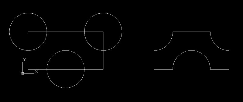

ReMark Posted September 16, 2012 Share Posted September 16, 2012 Exercise 2.1M Bracket Line...Circle...Mirror...Trim. The commands I used. Quote Link to comment Share on other sites More sharing options...
ReMark Posted September 16, 2012 Share Posted September 16, 2012 Exercise 2.2 Sorry, but I had to do this in a rush. I don't have much time left. Line...Offset...Circle commands used. Quote Link to comment Share on other sites More sharing options...

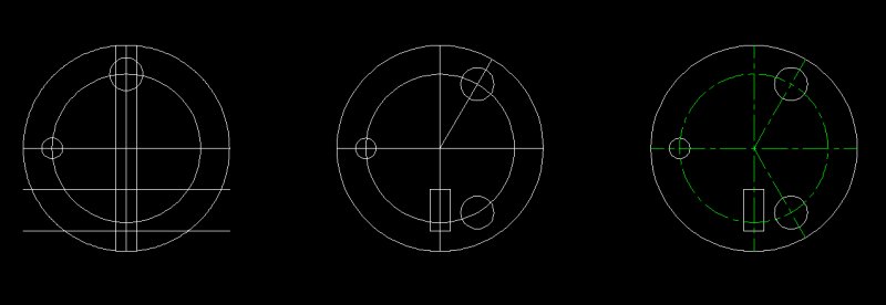

ReMark Posted September 16, 2012 Share Posted September 16, 2012 (edited) Exercise 2.3M Flange The start of things to come. Did you know you can draw a line at an angle using Direct Distance Entry right at the command line? One of the lines was drawn by starting the line command in the center of the circle then when asked for the next point I typed: @25.0 The other line was drawn by typing @25.0 Remember that AutoCAD has the angle "0" pointing to the right as its default and it thinks all angles should be drawn counterclockwise. I used the CENTER linetype for my green centerlines and the linetype scale I set to "2" in my Properties palette. Remember the Properties palette? Hint: Draw one of the angled lines and add the circle then use the MIRROR command to create the one opposite it. Edited September 17, 2012 by ReMark Quote Link to comment Share on other sites More sharing options...

fredericofrg Posted September 16, 2012 Author Share Posted September 16, 2012 help me please with the 1.5 Gasket i just cannot understand where i need put the circle and the distance for the line. Quote Link to comment Share on other sites More sharing options...
JD Mather Posted September 17, 2012 Share Posted September 17, 2012 ok thanks i already found how to do ^^ You didn't fix the errors I pointed out. Your second image shows the exact same errors. Quote Link to comment Share on other sites More sharing options...
ReMark Posted September 17, 2012 Share Posted September 17, 2012 help me please with the 1.5 Gasket i just cannot understand where i need put the circle and the distance for the line. frederico: Go back and take a look at post #92 of this thread (page 10). I have dimensioned the offsets to the centers of both circles just as they appeared in the original diagram. Haven't you used the OFFSET command yet? If you offset the top line 20.00 down and offset the 50.00 line on the left 20.00 to the right you will have located the center of the circle on that side. Once you have done this you have three options. 1) Do the same thing on the other side, 2) use the MIRROR command to create the circle on the right or 3) copy the circle on the left 70.00 to the right (make sure Ortho mode is enabled when you do this). Haven't you covered these commands in class? You should be familiar with many of the Modify commands by now. When you do a drawing you'll spend a good portion of your time making use of commands like Copy, Trim, Mirror, Stretch, Move, Offset, Array & Rotate just to name a few. You should practice each one of these commands paying close attention to the command line to see what input AutoCAD is expecting from you. As regards Exercise 1.4 and your second image that can be seen in post #101. Please pay attention to the comments made by JD Mather in post #102. There are some standards one should follow when dimensioning that you have failed to follow. Correct your drawing accordingly. Work that is done incorrectly will not be awarded a good grade by your instructor. Quote Link to comment Share on other sites More sharing options...

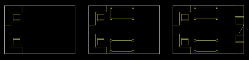

ReMark Posted September 17, 2012 Share Posted September 17, 2012 Exercise 1.9 The most important command you can use in this exercise is the MIRROR command because everything in the top half of the drawing is reproduced as a "mirror image" in the bottom half of the drawing. I would recommend use the midpoint of one of the two sides as the base point for the mirror command. In this exercise the student is asked to use both the GRID and SNAP commands. I turned off my grid (F7 key) to make objects easier to see when I created this image. Quote Link to comment Share on other sites More sharing options...

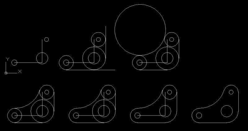

ReMark Posted September 17, 2012 Share Posted September 17, 2012 (edited) Exercise 2.10M Lever Crank The basic procedure I followed. As with many of these book exercises there comes a time when you run across one that leaves out certain vital pieces of information, like dimensions for instance, that forces the student to make certain assumptions based upon what he/she sees. Such was the case with this exercise. Looking at the diagram and my finished product I am relatively certain I have reproduced the object faithfully but the book's diagram could have provided a little more information. Edited September 17, 2012 by ReMark Quote Link to comment Share on other sites More sharing options...
