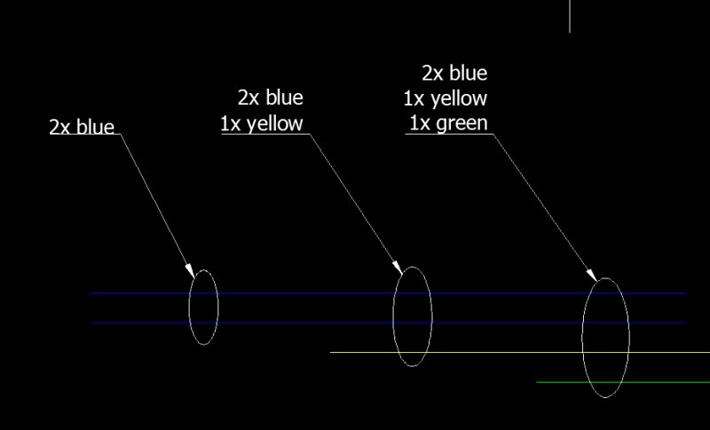

johmmeke Posted September 14, 2012 Author Posted September 14, 2012 pBE thx for the time you put in to explain this to me. For the desired result.. i post a screen shot of it. To keep it simple i have given the layers the name of the colors the lines have, the elipse is my selection. so it only counts the lines i select .. please keep the code simple greetz John Quote
pBe Posted September 15, 2012 Posted September 15, 2012 (defun c:LTL (/ spc p1 p2 str lead f lst) (vl-load-com) ;; Tharwat 08. 07. 2011 ;; ;; modified by pBe sep 15 2012 ;; (cond ((not acdoc) (setq acdoc (vla-get-activedocument (vlax-get-acad-object))) ) ) (setq spc (if (> (vla-get-activespace acdoc) 0) (vla-get-modelspace acdoc) (vla-get-paperspace acdoc) ) ) (while (and (setq p1 (getpoint "\n specify First Point :")) (setq p2 (getpoint p1 "\n Specify Second point :")) (setq ss (ssget)) (progn (repeat (setq i (sslength ss)) (setq layer (cdr (assoc 8 (entget (ssname ss (setq i (1- i))))))) [color="blue"] (if (setq f (assoc layer lst)) (setq lst (subst (list layer (1+ (cadr f))) f lst)) (setq lst (cons (list layer 1) lst))) )[/color] [color="blue"] (setq lst (vl-sort lst '(lambda (a b) (< (car a)(car b)))))[/color] ) ) (progn [color="blue"](setq str (mapcar '(lambda (j) (strcat (itoa (cadr j)) "x " (car j))) lst))[/color] (setq [color="blue"]lst nil[/color] lead (vla-addmleader spc (vlax-make-variant (vlax-safearray-fill (safearray vlax-vbdouble '(0 . 5)) (apply 'append (list p1 p2)) ) ) 0 ) ) (vla-put-textstring lead (apply 'strcat (mapcar '(lambda (x) (strcat x "\\P")) str)) ) ) ) (princ) ) HTH Quote
johmmeke Posted September 15, 2012 Author Posted September 15, 2012 Works perfect pBe, thx for the help now gonna try to take your extra code and learn something from it. that mapcar lamda is not that easy. thx again, greetz John Quote
