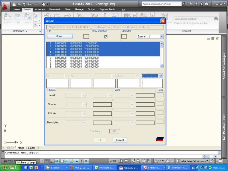

khoshravan Posted January 20, 2013 Share Posted January 20, 2013 (edited) Dear GeoBuilder I downloaded and loaded your LISP. But most of the boxes are greyed out and I can't choose them. They become active only when the delimiter is point. But points are part of the number and the delimiter is space. Also I expect after clicking OK, a line connecting the point, appears but nothing happens. ACAD only construct the layers. How can I make points visible? A screen shot is attached. Could you please help me to figure out what is the problem? Edited January 20, 2013 by khoshravan Quote Link to comment Share on other sites More sharing options...
BearDyugin Posted January 20, 2013 Author Share Posted January 20, 2013 Could you please help me to figure out what is the problem? In your file too many spaces. And when choosing a space divider, to separate the data is calculated each space Ie In your case * - space ****1****0.0000000****0.000000****0.00000****2****0.0000000****0.000000****10.00000 As this file sees the program _ - nil _*_*_*_*1*_*_*_*_*0.0000000*..._*_*_*_*2*_*_*_*_*0.0000000*... where #*X*Y*Z*COD*not used*not used*not used*not used... If the number of spaces is known and fixed, it is possible to separate you select "Other" and enter these spaces ****-delimiter then the program will understand this: _****1****0.0000000****0.000000****0.00000_****2****0.0000000****0.000000****10.00000 Because each line in the file is preceded by a blank, the first term, we still lost, but since you are not using COD, and point out that this COD is empty member COD****#****X****Y****Z Quote Link to comment Share on other sites More sharing options...
