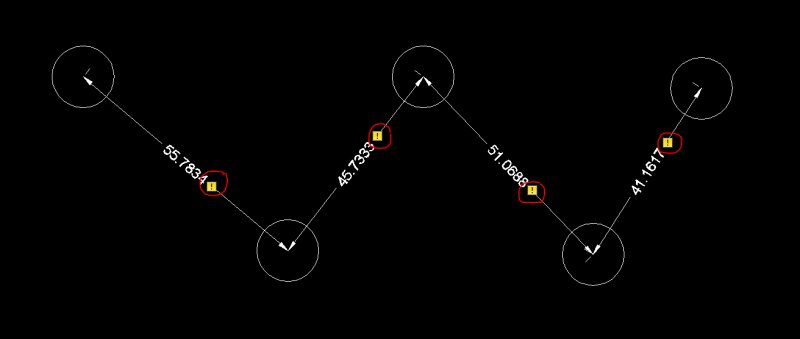

ReMark Posted October 12, 2012 Share Posted October 12, 2012 Give me a moment. I have some paperwork to fill out. I'll be back. Test completed. I get dimensions but all of them have yellow boxes next to them with an exclamation point in it. Maybe something to do with reassociating a dimension? Quote Link to comment Share on other sites More sharing options...

Tharwat Posted October 12, 2012 Share Posted October 12, 2012 Test completed. I get dimensions but all of them have yellow boxes next to them with an exclamation point in it. Maybe something to do with reassociating a dimension? Thanks for giving the time to try it Remark . Actually what you have mentioned is not related to the code at all , because it is simply create dimensions according to the current dimension style and nothing 's more . Quote Link to comment Share on other sites More sharing options...

ReMark Posted October 12, 2012 Share Posted October 12, 2012 My test drawing is just a new drawing with the overall scale factor reset from its default of "1" to "12". No other changes were made. I am using an imperial template. Note the boxes I have circled in red. Interesting. Quote Link to comment Share on other sites More sharing options...

Tharwat Posted October 12, 2012 Share Posted October 12, 2012 OMG , can you upload that new drawing Remark ? Or you may have the Annotative Dim. style on ? Change the dim style and try it again please . Quote Link to comment Share on other sites More sharing options...
