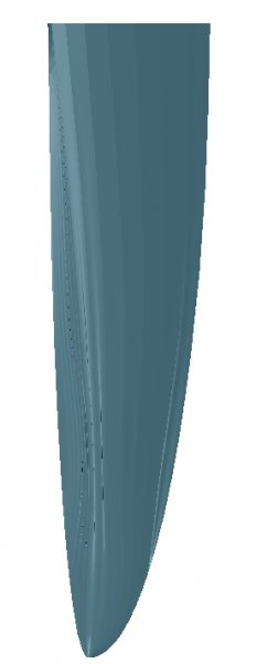

ReMark Posted November 27, 2012 Share Posted November 27, 2012 My feeble attempt. I give up. I have other things to work on. Good luck. Quote Link to comment Share on other sites More sharing options...

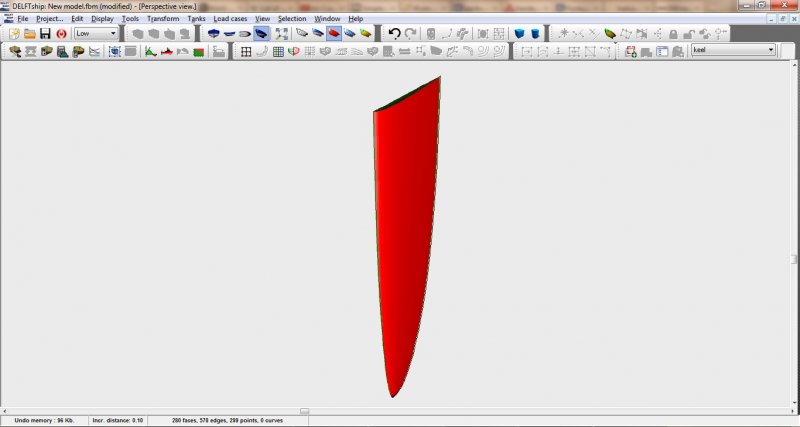

laukejas Posted November 27, 2012 Author Share Posted November 27, 2012 It's supposed to be a keel of a sailboat. More precisely, half of it. Attaching image it generated by other program. Quote Link to comment Share on other sites More sharing options...
ReMark Posted November 27, 2012 Share Posted November 27, 2012 Then I believe mine is wrong. Quote Link to comment Share on other sites More sharing options...
laukejas Posted November 27, 2012 Author Share Posted November 27, 2012 Can't tell from the screenshot, but I guess it's wrong. Something similar happens to me. It should result in the shape I uploaded in my previous post, the red one. Quote Link to comment Share on other sites More sharing options...
