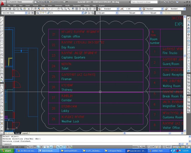

jitu
which layer??
for that font or all layers? because the font is showing something different here is that image.
is this image in red colour font is russian but if you see that showing for corridor (RJHBLJH) please check & let me know what is the exact problem

dbroada
Obviously I am guessing at the validity of this text as I can't read Russian but it doesn't look like those words are assigned to the correct style as you don't have any style set to use the russian font.
Create a new style using the appropriate font and then change the style of the text you need to display in Russian.
Alternatively, as the ROMANS text elswhere seems to be displaying russian text you will have to type it all again after checking how the font is mapped. Windows has a character map but I don't know if it works for shx fonts or not.

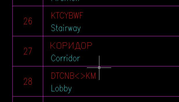

dbroada
I was mistaken about the layer being turned off.
I have changed the style to one using the rus.shx font and this is what I get for corridor.
