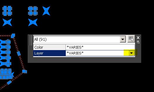

Perhaps a more intuitive way is by using the QUICK PROPERTIES palette.
Select all of the items in question, then in the QUICK PROPERTIES palette,
where it sounds like the layer value will say VARIES, you can just select the layer
you want them all to be moved to.
You could do the same thing in PROPERTIES, but I am a huge fan of the QUICK PROPERTIES functionality.
