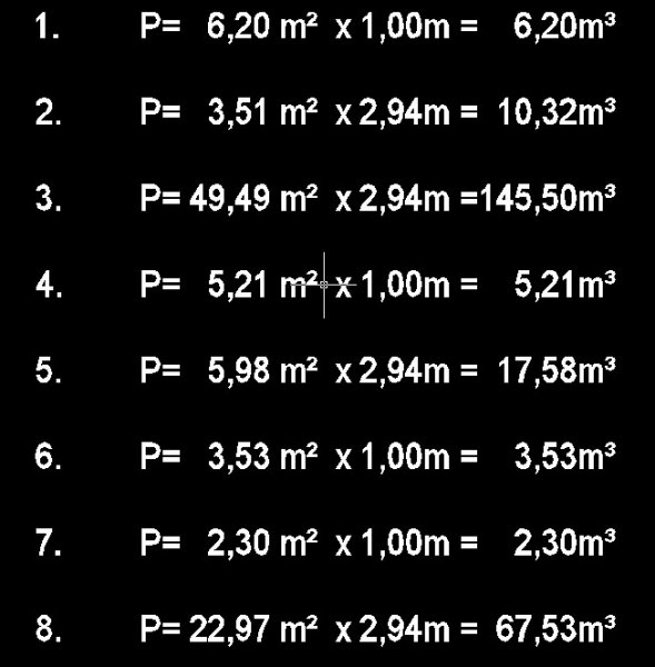

Butch Posted December 21, 2012 Posted December 21, 2012 Guys hi! Need some help. Can AUTOCAD sum values that are entered as text values? Attached is a table text whose right final values should be all sumed up? Is this possible inside AUTOCAD? Thanx! Quote

Butch Posted December 22, 2012 Author Posted December 22, 2012 Lisp loaded and activacted. It asks to select object but whatever I click it says "0 object found". I tried with text, Mtext, exploding dimensions and using their text...nothing Quote
