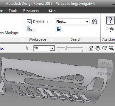

pqphillips Posted January 18, 2013 Author Share Posted January 18, 2013 [ATTACH]39695[/ATTACH][ATTACH=CONFIG]39694[/ATTACH]Something like this?Well, I tried to attach the dwg file but it was too large. see images That's exactly what I am looking for. Unfortunately, AutoCAD won't open or import .dwfx files. Quote Link to comment Share on other sites More sharing options...

ReMark Posted January 18, 2013 Share Posted January 18, 2013 Won't AutoDesk Design Review open those types of files? Not that I would know what you would do with it then if that were the case. Quote Link to comment Share on other sites More sharing options...
pqphillips Posted January 18, 2013 Author Share Posted January 18, 2013 Won't AutoDesk Design Review open those types of files? Not that I would know what you would do with it then if that were the case. Nope. (Stupid 10 character minimum) Quote Link to comment Share on other sites More sharing options...

JD Mather Posted January 18, 2013 Share Posted January 18, 2013 Nope. (Stupid 10 character minimum) Huh? (oh I get it - you wanted a simple Nope response) but it should be Yes, Nope is wrong. You should be able to open the *.dwfx with Design Review or simply with your browser (if using IE and Vista or Win7). Quote Link to comment Share on other sites More sharing options...

JD Mather Posted January 18, 2013 Share Posted January 18, 2013 That's exactly what I am looking for. Unfortunately, AutoCAD won't open or import .dwfx files. You could download a free 30-day trial of Autodesk Inventor. If you do a lot of this work (or maybe even this single project) could cover the extra $1395 Emboss.ipt Quote Link to comment Share on other sites More sharing options...

pqphillips Posted January 19, 2013 Author Share Posted January 19, 2013 Thanks for the help, everyone. I got it all set up now. Quote Link to comment Share on other sites More sharing options...
SLW210 Posted January 21, 2013 Share Posted January 21, 2013 Thanks for the help, everyone. I got it all set up now. Glad you got it sorted! Do you mind sharing how you went about setting it up? Quote Link to comment Share on other sites More sharing options...
pqphillips Posted January 21, 2013 Author Share Posted January 21, 2013 Glad you got it sorted! Do you mind sharing how you went about setting it up? Sure! I downloaded the Inventor trial, created the tube, and used the Emboss feature to do it. Easy Peasy (once I figured out where the Emboss command was). Quote Link to comment Share on other sites More sharing options...
JD Mather Posted January 21, 2013 Share Posted January 21, 2013 Sure! I downloaded the Inventor trial, created the tube, and used the Emboss feature to do it.... I did attach the *.ipt file up a few responses ago. You might download it and pull down the red End of Part marker to see how I did it. (I rolled up the EOP as a way of reducing file size - note that it also serves as a history where you can see step-by-step how something was created in Inventor.) Quote Link to comment Share on other sites More sharing options...
