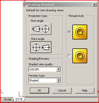

Dadgad Posted March 10, 2013 Share Posted March 10, 2013 (edited) Welcome to CADTutor. As you are using Autocad 2013 you can quite easily generate 2D drawings of existing 3D solids by using the VIEWBASE command. That is the good news, the bad news is that will only help you once you have managed to create or acquire the 3D solids which you wish to represent. Should you have them, be sure to set your Drafting Standards BEFORE using the VIEWBASE command, right click on your LAYOUT tab to access the dialog box shown in the image. In the states we favor 3rd angle projection style, Europe and some other locations favor 1st angle projection style. You can also do these views without modeling them first. Edited March 10, 2013 by Dadgad Quote Link to comment Share on other sites More sharing options...

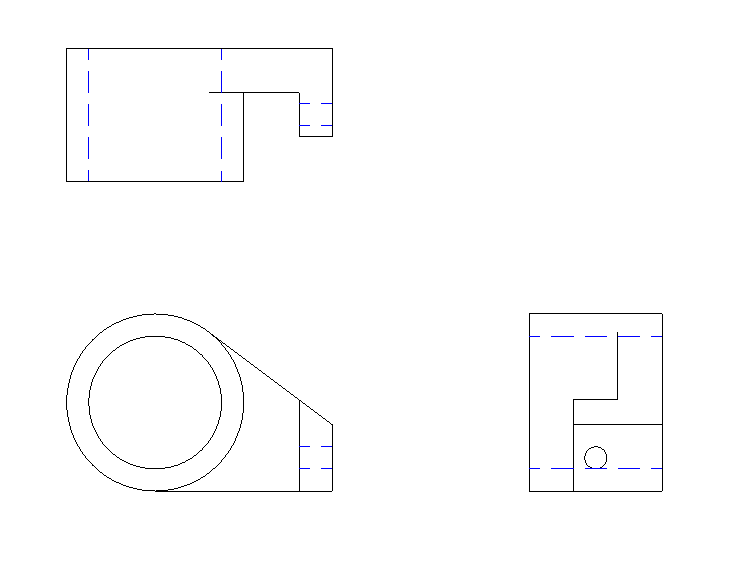

ReMark Posted March 10, 2013 Share Posted March 10, 2013 I'm puzzled by your lack of response but I will give you the benefit of the doubt and assume you have been busy as a bee creating the required orthographic views. Here is one of the anchor base I'll share with you. Kindly return the favor if and when you have the opportunity. Quote Link to comment Share on other sites More sharing options...

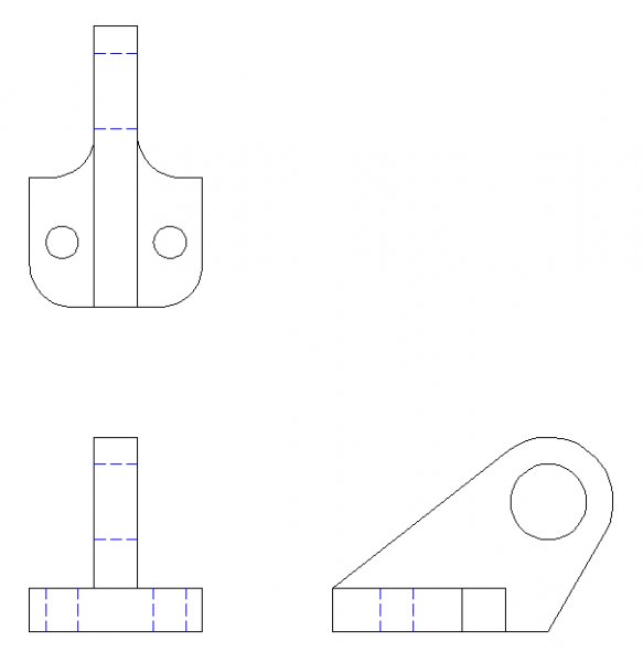

ReMark Posted March 11, 2013 Share Posted March 11, 2013 LearningCAD: How's the CAD learning process going? Making any? Your cylinder support is depicted above. Quote Link to comment Share on other sites More sharing options...

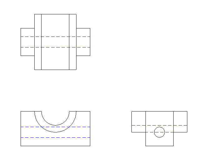

ReMark Posted March 11, 2013 Share Posted March 11, 2013 Bearing base. The only way to get good at this is to practice, practice and then practice some more. It doesn't hurt to ask questions too. We'll gladly guide. In the end it is your assignment to do. Good luck. Quote Link to comment Share on other sites More sharing options...
