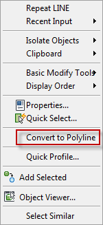

I am having a problem with AutoCAD 2011. Here's the problem step by step:
1. Select a line
2. Right click and select polyline
3. Select width
Here's where the problem arises. ACAD used to prompt for a width now it runs the PEDIT command and asks me to select a line and then gives the usual pedit commands via the command line.
Not sure what has happened here but would appreciate any advice on how to reset this.

SLW210
The "^C^C" is a double cancel (same as using Esc twice) and is supposed to be there.
Share this post
Link to post
Baber62
@SLW210
When I looked on a colleagues machine the "^C^C" was not included on his shortcut menu command for a polyline.
What was happening was that with a polyline selected (whose width I wanted to adjust), the double cancel command invoked the pedit command and would then require me to select the polyline again and follow through with the pedit from the command line to adjust the width. In autocad 2010 and later versions when you select a polyline and right click you see a polyline command has been added to the shortcut menu. When you click on this a further shortcut menu is opened allowing you adjust the width when this has been selected it's a matter of simply using the numpad on the keyboard to enter the required width and press enter. Rather than the laborious task of having to go through the pedit command.
I hope this explains it SLW210.
Share this post
Link to post
SLW210
I know all that and use it that way myself, in my AutoCAD the command for pedit width is ^C^C_pedit _width \_exit, just as you HAD and what is SUPPOSED to be there, the ^C^C is not your problem.
If you prefer not to repair it correctly, that is fine by me, I was just letting you know your Macro was correct before you edited it.
