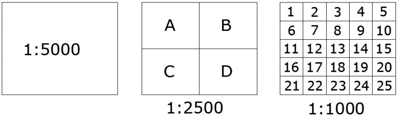

You gave me some ideas. Let me explain a bit more about the setup. Our maps are split into 1:5000, 1:2500, 1:1000. They are in 3 subdirectories of the mapping folder. I don't have permission nor do I wish to change the folder structure of this in any way. I wish to lift the tiles out of it. The files names in each folder are as follows: (see image below).
1:5000 Map tile number, no additions - (example) 5411.dwg
1:2500 Map tile number plus A,B,C or D - (example) 5411-A.dwg
1:1000 Map tile number plus 1 to 25 - (example) 5411-18.dwg
(Edit: Each map tile could have a 1:5000, along with several 1:2500 and 1:1000 to complete the full tile and it varies from tile to tile)

This code works in that it will insert the tile as set out in the code and insert it into the current drawing. I need to get the code to search the "M:\\os\\Maps\\AutoCAD\\" directory for all blocks beginning with the four digits from the block "thumbnail" I select in the drawing. But I need to put them in a new drawing......
Can someone help me with how to go on from here?
