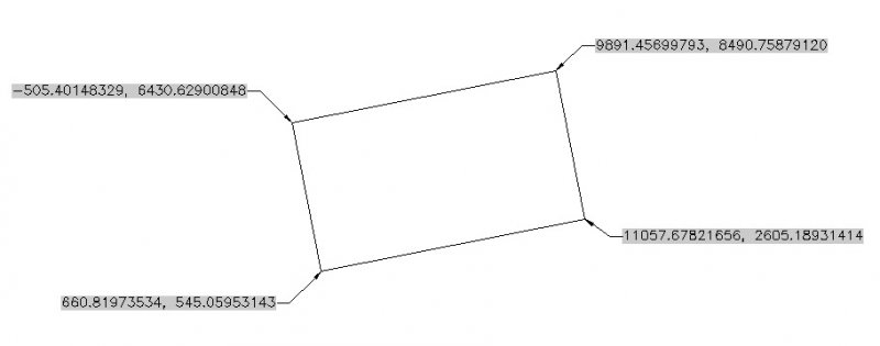

nestly
That's an interesting read, but IMO is not the reason in this case.
There is no object in AutoCAD called a "Rectangle" rather it's just a polyline to AutoCAD, and my understanding is that polylines are calculated based on the distance and angle of each vertex from the origin, so it's not as simple to get the area as multiplying the length and width.

You know it's a "rectangle" but AutoCAD doesn't.... it's just another polygon. AutoCAD doesn't know if the sides are supposed to be the same length or different, AutoCAD doesn't know if the corners are supposed to be perpendicular to each other, or not. Autocad doesn't know if the lines are supposed to be perfectly horizontal and perfectly vertical.... therefore AutoCAD has to look at each vertex independently, calculate a triangular region to that vertex, then subtract or add all the other triangulated points that have overlapping regions.
Re: 16 digits of accuracy....... what is the exact diagonal distance across the corners of a 10559 x 6000 rectangle..... hint...( is it more or less than 16 digits)

ibach
OK, went trough all points individually, got no error up to 8 decimal places, did my math and got same , correct result. No error. Used vectorial equasions, just like acad does.
Started acad again, got same error again...
AutoCAD is jus a big calculator, and it should do its work correctly, as simple as that.
But it is actually not the error it self what I'm interested about, but the origin of the error, and what went wrong.
I do know that autocad will calculate the area correctly if I draw new ...ok... polygon like that one in same drawing.
What could have happened to the old one?! Why, if all vertexes are where they are supposed to be, area is not calculated as it should be?
Why the error at the end is 2, not 1 if it's all about roundingup the numbers?!
This is mathematically odd, strange, interesting...
New test: Copy the polygon 1000 units under the old one, explode it, join again and look at the properties... number is 63353999.99999996 now!!!
What the f***! I've changed no geometrical data, just the position.
Copy the polygon 1000 units to the left old one, explode it, join again and look at the properties... number is 63354000.00000002!
What is the difference between copy to the left and the copy under the old one? Copy is a copy is it not?!
Obviously it is not.

nestly
This is what AutoCAD "sees". It is a rounding error in the triangulation. Rotate or move the polygon a little bit several times and you'll likely the area in properties change by at least +/- 0.00000004.
