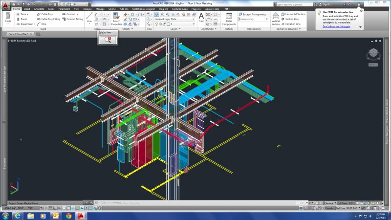

hertz hound Posted June 28, 2013 Share Posted June 28, 2013 Switchgear is usually custom to the job so it is made for each drawing. Some sections are standard but the arrangement and the breaker sizes are always different. I think it is better to build your own. Later if you need to do detail views of electric rooms it is nice that all the work is already done, right down to the labels on the large breakers. In my opinion they don't make connectors easy (that is another reason why I want to learn Revit). I don't have the time to put or change connectors on everything, so I usually don't. If you want to keep a 1-1/4" spacing on your conduits (screwdriver handle), and you have different size conduits in different racks, it is never ending changing the locations of your connectors in your custom trofts, j-boxes and panels. It would make life easier if they were connected, but I think it takes less time to move things individually than to place connectors. Maybe the other trades use the solution tips, I always leave it off so I don't see all the yellow warning triangles. It was a topic in a coordination meeting once. I guess my un-connected conduit's yellow triangles were showing up as hits with the dry mechanical. The BIM manager did not have a problem, just the one trade when he would run a clash check. It was discussed on how you can change the scale to make them smaller. I hope I don't sound like an old pro at this because I am still learning every day Enjoy Quote Link to comment Share on other sites More sharing options...

KeithBrown Posted July 5, 2013 Share Posted July 5, 2013 What you should probably do is just make a mvpart that is parametric that is nothing but a connector and a very small base. you can then attach each of your conduits to a base. Then using the OBJECTANCHORATTACH command you can anchor each of these small bases to a generic parametric switch gear that is nothing but a box. This will allow you to connect as many of these conduits to the switch gear as you like. In addition, because the mvparts that the conduits are attached to are anchored to the switchgear, when you move the switchgear, the conduits will also move to maintain their connection. This is easier than creating a custom switchgear everytime you need one. Quote Link to comment Share on other sites More sharing options...
hertz hound Posted July 11, 2013 Share Posted July 11, 2013 What you should probably do is just make a mvpart that is parametric that is nothing but a connector and a very small base. you can then attach each of your conduits to a base. Then using the OBJECTANCHORATTACH command you can anchor each of these small bases Great tip. I will try that. I like the idea of the base being parametric so I can change the size and allow for different size strut and or conduit. Then I can use them to snap to trofts and cabinets. It is hard to tell from the screen shot, but alot of those conduits are on back to back strut with another row of conduits underneath. It is alot to adjust when they are not atached. Thanks. And thanks StykFacE for the unistrut! Quote Link to comment Share on other sites More sharing options...

hertz hound Posted August 18, 2013 Share Posted August 18, 2013 (edited) OK here is the conduit connector plate .apc file https://dc1.safesync.com/LMFjDWth/Conduit%20Connectors.zip?a=n9uPf6uaYwc Here it is as an example in a dwg file https://dc1.safesync.com/LMFjDWth/Ridged%20connectors.dwg?a=Lw7fO7wDNKo They work great to keep the conduit aligned with a 1-1/4 space between conduits and a 1-5/8 space from the wall. They stay connected with the conduit when the connector plate is moved , but when the connector plate is attached with an object using the OBJECTANCHORATTACH command only the plate stays attached to the object and not the conduit with the plate. Any suggestions? Edited August 18, 2013 by hertz hound Quote Link to comment Share on other sites More sharing options...
