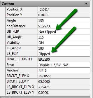

Does anyone know a clean way to toggle a specified flip parameter using auto lisp visual lisp?
I use the getdynprops, getdynpropvalue, putdynpropvalue [by Jeff Mishler based on code from Steve Doman, Herman Mayfarth and Tony Tanzillo] for most of my dynamic block changing needs but I can't get it they don't seem to work for the flip parameter.

TheyCallMeJohn
Lee Mac,
I have multiple flips states. Is there a way to pass it a the name and the parameter I want to set it to? Some are accesible by the user and some are not as they are controlled by lookup parameters.

Lee Mac
Lee Mac,
Sure, in general you could use my Set Dynamic Property Value function.
For your case:
(LM:SetDynamicPropValue <VLA-Object> "UB_FLIP" 1)
or:
(LM:SetDynamicPropValue <VLA-Object> "UB_FLIP" 0)
