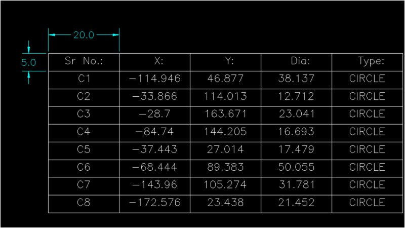

Hi Guys,
Here is what I could do till now with the below code (mainly from Tharwat, but I tweaked a just bit):
1) It asks for the user input to specify the origin (basically setting the UCS)
2) Export XY & Diameter detail to the excel file (converted XY to current UCS using trans function)
3) Adds a 0,0-Origin text so that user knows whether the origin is correct or not.
what I'm looking for is this :
1) All the entities (arc or circles) should be numbered on the drawing 1,2,3 etc....
2) The table what it creates should have the First column for serial numbers (per item 1) and Fifth column for the type of entity (e.g. Arc or Circle) to identify the object type.
Can someone help me on this please?

Why not show the output you are hoping for? Make a table showing what it should look like. Show some arcs and circles numbered in the drawing the way you would like them shown.
Although it would be fun to re-write your lisp, I stuck with your format.

Nice and thanks !!
Wow, this is exactly what I was hoping for. great stuff Commandobill.
I'll take some time to completely understand how you did it compared to what I posted.
Say...if not too much to ask for. would it be possible to list down items type wise. Like all circles are listed first, then all arc and then ellipse?
Or may be if possible, say Circles are numbered as C1, C2...and arcs are numbered A1, A2....and ellipse E1, E2...
Just curious...
Something like this?

To me, Commandobill's lisp works perfectly fine. I see Blackbox's lisp is a neat in terms of error handling, but its missing some of the features that I had like allowing user to select origin, then trans to that ucs and dont add text.
Apart from this, I'm taking this lisp to next level by inserting a datalinked table and bring back to AutoCAD by using an utility from J. Villareal.
Table style (standard) is one of my biggest hurdle. I'm not able to modify the standard table style and use it repeatedly. Can't save as Standard template. Any ideas? Or Should I post it as a separate thread?
