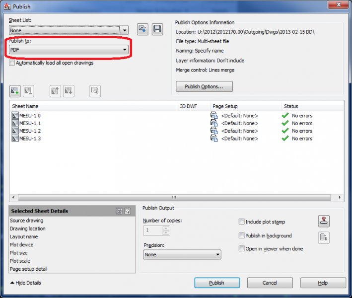

Is this setting the culprit?

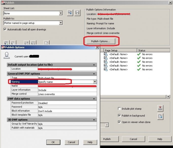

See if this works for you.

Hey SLW,
Thanks for your swift reply, The Name, and Naming rows are showing N/A and I cannot click them. Any other ideas? Other than click "OK" 325 times?

SLW210
You must have something selected or unselected somewhere that is not allowing to change that.
Can you post an Image of your Publish settings?

tmelancon
But wouldnt that be Multiple Sheets in a single file? I need all 325 drawings to be 325 individual pdf's with the same name as the DWG name. Will that work?
Share this post
Link to post
tmelancon
I selected all drawings in my publish dialog box. Then I selected 'Publish Options'... When set to SINGLE SHEET, which is what I need, it shows N/A... If I select Multiple Sheet File, it will allow me to specify name and stuff but I do not want a multiple sheet file. I am wanting 325 separate files all with the name to correspond with the drawing that it was PDF'd from. I tried the way you are talking about (I selected just 10 for a test run)... It put them all in 1 file... Any other ideas to save me from 325 enter presses?

SLW210
I do not get prompt for a name when I select Single Sheet.
