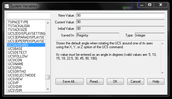

ReMark
You're looking for a system variable.
Command: UCSAXISANG
Enter new value for UCSAXISANG :90
Then press the Enter key.
Done.

rickmalabares
Command: UCSAXISANG
Done.
Thanks ReMark
That's the command I was looking for.
