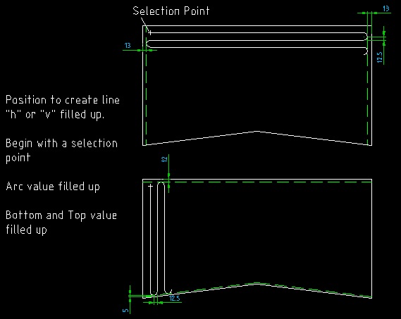

Hello guys,
Someone knows if's possible I fill up one area, as the picture, with one polyline oriented (or as a guided line), informing the lisp code the initial point, the radius of return line, and the space limits (as the limits line), horizontal or vertical to guide the lines until the whole area it's completely filled up?...
Thanks in advance...

This is my version, but I don't know what do you think - it may in some cases be shorter or longer fill than the opposite boundary edge (end of snake)...

Marko_ribar, thanks for help me, the code that you wrote it's almost that I need, but the lines are drawed only in a regular region (rectangle)? It's possible select other kind of region? And as the picture, the arcs following the limits of inclination... I was thinking in some thing like I fill up the region following the limits using as a "rule" to drawing the line, like: if the start point was inserted it's possible to draw the line until the limit line and where we get crossing point of the limit line (green line) it could be decreased to creat the end of first line using the radius as a reference, after that drawing the arc and follow again the "rule", doing it until the end of drawing, but I don't know if's possible work in this way.
Thank's again and sorry about the english!...

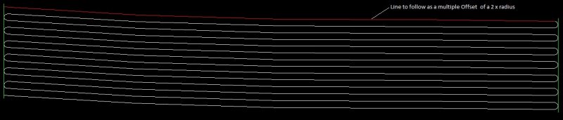

BIGAL, thanks, I don't know if I'm doing it wrong, but using your code I create only lines following the region (outline), is it correct?...
This request reminds me of this thread - perhaps that program may help.

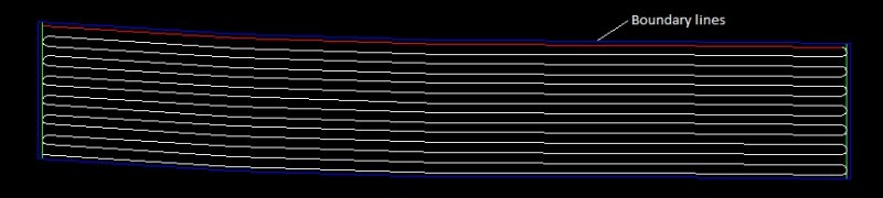

Lee Mac is almost that... but, I'm filling up a irregular region!... I'm showing another drawing to explain about it...
It is solvable but its not a quick task, so I am only offering maybe a method Lee may be able to help with code
offset outside pline as required
create line at required angle and spacing (see my chevron.lsp) trim to new inner pline
using a list of the lines left to right just alternate the fillet command top and bottom
should look like image.

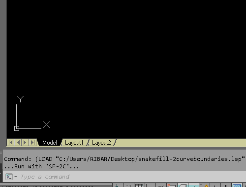

CafeJr, here try this and reply if something's wrong... It should now work with 2 opposite open 2d curve boundaries...
(defun c:snakefill-2curveboundaries (/ *adoc* odd even osm pea ch r lpl upl ip dir lplo uplo spc xl1 c1 xl2 c2 cl ss)

(defun c:sf-2c nil (c:snakefill-2curveboundaries))
(prompt "\n...Run with 'SF-2C'...")

Master Marko_ribar,
I don't know if is it another thread, but, I was thinking that this code would be one "esay" code, I'm really shocked about it! It was a big code and NOT so easy!!!... Well, to this code follow one reference line of the boundary plan like the picture, is it possible?
Thank you a lot!!!... I'm really grateful!!!...
If 3rd boundary is an arc I think it's possible... But bend must be between 1st and 2nd side boundaries - something like circle isn't possible... And I think this is an example of multiple copy of 3rd boundary in vertical Up/Down direction rather than offsetting... As I said if it's arc than it's possible... The princip is the same as above posted code... Just instead of Xlines you need intersect with Arcs in Horizontal/Vertical directions... I think you have much info to construct this on your own... If you want you can show us your result... We'll be happy to see that it works... Just keep in mind when searching for centers of side arcs I'd use 'intersectwith method with option acextendthisentity (arc is the first VLA-OBJECT)...
M.R.
M.R.
In fact the boundary line is a pline limit of one area that I has to fill up, It's like the next picture... I'm trying to fill it with a "snake line" following some rules. I can say you that it's only the first step of the drawing! But is the worst of them...
EDIT: Opsss... Sorry, but, are you ask me to show you the result of it? :(
I have no ideia how to do in this way, I'm studying another way to do, but trying to compile another codes!...
Edited by CafeJr
