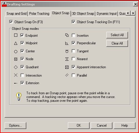

nestly Posted November 7, 2013 Share Posted November 7, 2013 I'm a bit confused because the poll says "AutoSnap", but describes "OSNAPs" Not the same thing... OSnaps work even when all the AutoSNAPs are disabled. I keep all the AutoSnap options on, and 3+ OSNAPS running for both 2D and 3D. 2D = Endpoint / Midpoint / Center /Quadrant / Intersection 3D = Vertex / Midpoint on edge / Center of face Quote Link to comment Share on other sites More sharing options...
MSasu Posted November 7, 2013 Share Posted November 7, 2013 I'm using Endpoint, Midpoint, Center, Quadrant, Intersection and Insert set on Auto. What really scare me is the activation of Nearest, since I was some issues in the past that mostly were coming from that; but some people insist of keeping it on Auto, even if advise them against. Quote Link to comment Share on other sites More sharing options...

Glen1980 Posted November 7, 2013 Share Posted November 7, 2013 I use end, node, centre, quadrant, intersect, apparent intersect and extension Object snaps and mid, nearest, perpendicular and between to points from shift right click as needed. I don't trust nearest, perpendicular as object snaps. Quote Link to comment Share on other sites More sharing options...

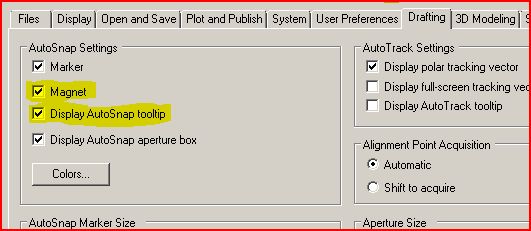

SLW210 Posted November 7, 2013 Share Posted November 7, 2013 I have them on and a few set, but usually I Shift+Right-Click and select. AutoSnap Controls the display of the AutoSnap marker, tooltip, and magnet. Also turns on polar and object snap tracking, and controls the display of polar tracking, object snap tracking, and Ortho mode tooltips. The setting is stored as a bitcode using the sum of the following values: 0 Turns off the AutoSnap marker, tooltips, and magnet. Also turns off polar tracking, object snap tracking, and tooltips for polar tracking, object snap tracking, and Ortho mode 1 Turns on the AutoSnap marker 2 Turns on the AutoSnap tooltips 4 Turns on the AutoSnap magnet 8 Turns on polar tracking 16 Turns on object snap tracking 32 Turns on tooltips for polar tracking, object snap tracking, and Ortho mode OSModeSets running object snaps. The setting is stored as a bitcode using the sum of the following values: 0 NONe 1 ENDpoint 2 MIDpoint 4 CENter 8 NODe 16 QUAdrant 32 INTersection 64 INSertion 128 PERpendicular 256 TANgent 512 NEArest 1024 QUIck 2048 APParent Intersection 4096 EXTension 8192 PARallel To specify more than one object snap, enter the sum of their values. For example, entering 3 specifies the Endpoint (bitcode 1) and Midpoint (bitcode 2) object snaps. Entering 16383 specifies all object snaps. When object snaps are switched off using the Osnap button on the status bar, a bitcode of 16384 (0x4000) is returned, in addition to the normal value of OSMODE. With this additional value, developers can distinguish this mode from Object Snap modes that have been turned off from within the Drafting Settings dialog box. Setting this bit toggles running object snaps off. Setting OSMODE to a value with this bit off toggles running object snaps on. Quote Link to comment Share on other sites More sharing options...
Tiger Posted November 7, 2013 Share Posted November 7, 2013 In AutoCAD: End, Mid, Cen, Int and perhaps a few more always running. I type the rest. Never have Nearest on running. I have very few things that I insist users should or should not do - not haveing Nearest on always is one of them . Civil: No Osnaps running at all, I type in them all. There is just too many lines and objects and whatnots for me to be sure what I will snap to this time. Quote Link to comment Share on other sites More sharing options...
Dana W Posted November 7, 2013 Share Posted November 7, 2013 I tend to run with most of the object snaps on, never nearest(what the &^% is that used for), but I do turn them off occasionally, mostly when moving or copying mtext objects. The snaps on the text objects are different with each justification parameter, so they can be bothersome. Quote Link to comment Share on other sites More sharing options...
