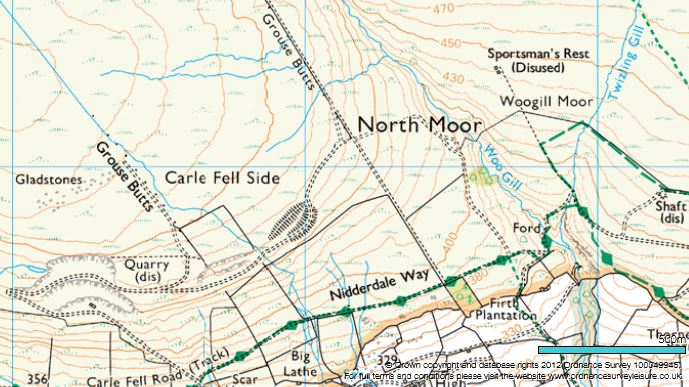

How do I create hills from on OS map?
I has tried this with no success and I would be very grateful for some advice.
I have looked at the sandbox tools and also tutorials but cannot find a good one.
Do I need to raise all the lines to their heights and then look to generate the surface or can it be done straight from the 2d OS map?
Thanks you to anyone with the answer
