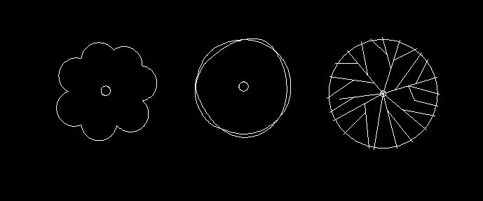

a3dtot Posted February 7, 2014 Share Posted February 7, 2014 Would it be possible for you to replace the POINTs with blocks and then converting the new drawing as DXF. Are you converting a newer version drawing to release 12? If so you may want to step down (ie: 2014 to 2010 to 2007 to 2002 to R14 to R12) Actually it doesn't take that many steps just an example. I have run into odd problems when converting 2013 dwgs to R14, I had success when I converted first to 2009 (or 2007) then to R14. Good luck Quote Link to comment Share on other sites More sharing options...
Treehugger Posted February 7, 2014 Author Share Posted February 7, 2014 Thanks for your prompt responses guys. Much appreciated. a3dtot: could you spell out what you mean by replacing points with blocks please (apologies my cad skills are extremely limited so I need spoon feeding). I will try the stepping down approach too. I am currently using 2010. Cheers Quote Link to comment Share on other sites More sharing options...
ReMark Posted February 7, 2014 Share Posted February 7, 2014 A block is just a symbol. Here are three examples of a tree block. Quote Link to comment Share on other sites More sharing options...

a3dtot Posted February 7, 2014 Share Posted February 7, 2014 For the stepping down you would need to have earlier versions. Sorry I didn't mention that before. I have all the way down to 2005. Just for that reason. Blocks or wblocks are a group of objects or a single object that can be made with an insert point and can be inserted into any drawing. Once it is inserted all the items that have been blocked together stay together as one entity. The best for you seems to be to wblock and save the file to a library that you could use to store your symbols, marking, etc. The wblock allows you to create a "write" block (it creates a file of the block that you have created and can be stored for multiple uses.) Type in "WBLOCK" at the command prompt and dialog box will appear and input the required information. To insert the wblock just type in insert at the command prompt and find the file (block) you want to insert. You could see if you could find some tutorials on block creation. It's a quick learn. I suggest this because it may be the points converting that is causing some of the difficulty. I haven't used points in many years so I'm not sure if they have any new features. Quote Link to comment Share on other sites More sharing options...
