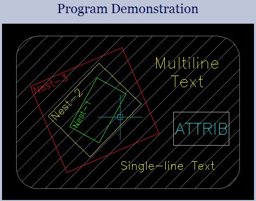

shailujp Posted March 20, 2014 Author Share Posted March 20, 2014 I will post the example tomorrow. In the mean time I have copied a snap from Lee Mac website to explain it better. There are 3 nested entities on this snap and have copied all of them with a new name with prefix "Modify_". Now when the design is finalized, not all new items go on the final version. So, if all my "modified nested 3" versions need to replace the "nested 3" I will have to explode all blocks to expose nested 3 & modified nested 3 to be able to pick & replace. And there are so many of this and my file size troubles me the most. Does this explanation work for now? Quote Link to comment Share on other sites More sharing options...

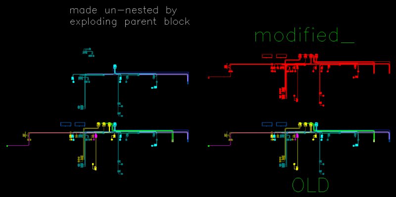

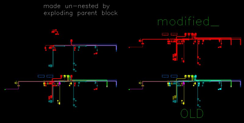

shailujp Posted March 21, 2014 Author Share Posted March 21, 2014 Hi MSasu Please don't miss that this isn't a develop-on-demand establishment! Just politely asking for help and I know that most people like you are willing to help. I tried your lisp and works well. But then there is this nested block issue is indeed the main culprit and thats the main reason for posting this thread. Could this be resolved? Here is how I have tested it. Before and after snaps. Quote Link to comment Share on other sites More sharing options...
