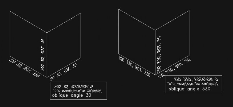

You will need 2 text styles for Iso text, then you will create 3 macros per text style. I am attaching a clip of a couple of macros, one for each text style.
One style will have the Oblique angle set to 330, another one set at 30. I call mine ISO 30, and ISO 330.
So the macro
^C^C_mtext;\Style;"iso 30";R;30;\
will use the style ISO 30 and rotate it 30 degrees. You will create two more macros changing the value after the R; with 90 and again with 330.
Do the same for the other style by creating 3 macros with a rotation of 30, 90, 330.

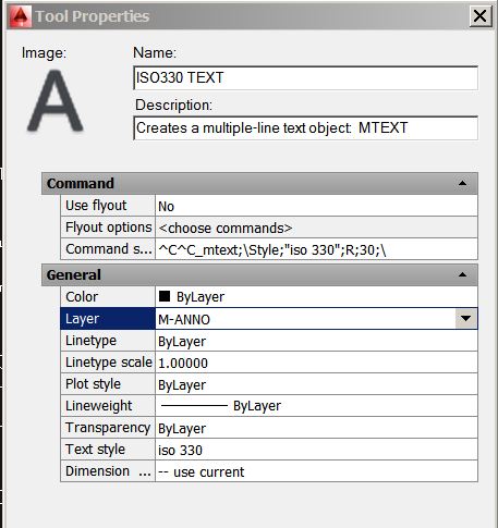

The style definition is in the drawing. You must have the two iso styles because of the need for the oblique angle, that is only set in the style. The style name can still use the simplex.shx font. Don't confuse font name with style name, a style simply gives you a way to set settings for that style using any font type.
See attached for the tool palette text tool. To start you can drag any piece of text from the screen to your tool palette. Then modify properties to match what I have posted, adjusting it for your own style name and rotation needed.
