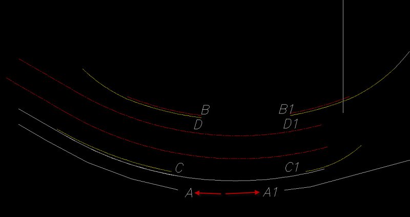

Sengna Posted March 26, 2014 Share Posted March 26, 2014 I tried to connect these arcs together as you can see on the red arrows but they didn't look smooth, i use 3 points arc and another mothod was circle command. How would you guys do it? Quote Link to comment Share on other sites More sharing options...

Sengna Posted March 26, 2014 Author Share Posted March 26, 2014 It is not very clear to me which arcs you are connecting and how. I can see the red arrows but can't work out what is happening. There are quite a few arcs in the picture. Without knowing what you want to accomplish, I would tend to use a circle and trim afterwards in most cases. hi, eldon, please see attach, i tried to join: arc A with A1, B with B1 ......and so on, i use the method as Steven-g suggested, it works well and smooth join for continue line but can't for hidden or segment arc. I still don't know how to attach DWG file via the forumz Remark. Quote Link to comment Share on other sites More sharing options...

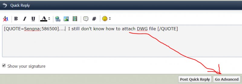

JD Mather Posted March 26, 2014 Share Posted March 26, 2014 .... I still don't know how to attach DWG file click on paperclip and follow on-screen prompts. Quote Link to comment Share on other sites More sharing options...

Dana W Posted March 27, 2014 Share Posted March 27, 2014 hi, eldon, please see attach, i tried to join: arc A with A1, B with B1 ......and so on, i use the method as Steven-g suggested, it works well and smooth join for continue line but can't for hidden or segment arc. I still don't know how to attach DWG file via the forumz Remark. [ATTACH=CONFIG]47698[/ATTACH] News flash: A and A1 are not arcs, they are lines, a bunch of short little lines. C and C1 have hugely different radii. Another way to make the radii sort of join is to draw a vertical line in the open space between them, from anywhere above them to anywhere below them and use the EXTEND command to extend the arcs to the line, then erase the line. If the arcs have common centers and equal radii, they will meet the line at common points. Quote Link to comment Share on other sites More sharing options...

Sengna Posted March 27, 2014 Author Share Posted March 27, 2014 News flash: A and A1 are not arcs, they are lines, a bunch of short little lines. C and C1 have hugely different radii. Another way to make the radii sort of join is to draw a vertical line in the open space between them, from anywhere above them to anywhere below them and use the EXTEND command to extend the arcs to the line, then erase the line. If the arcs have common centers and equal radii, they will meet the line at common points. Extend command works well too, thanks Dana W Quote Link to comment Share on other sites More sharing options...
