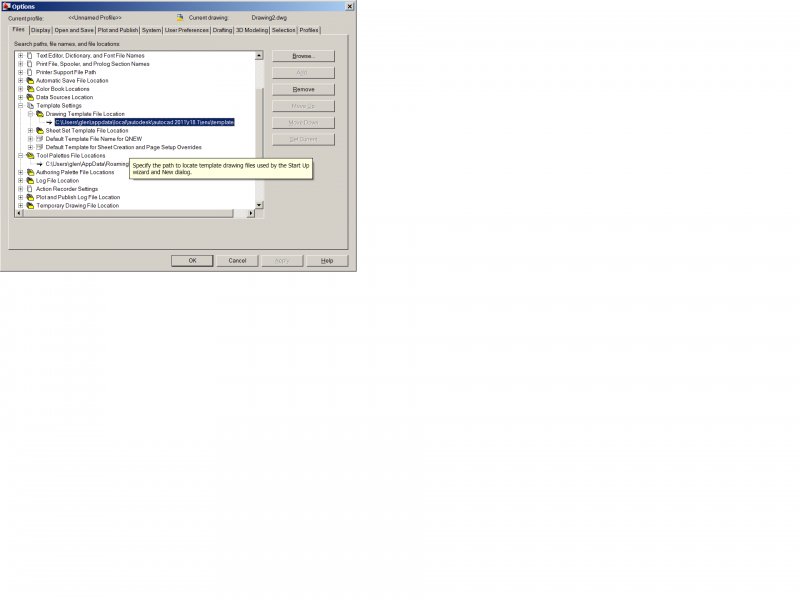

Glen1980 Posted April 3, 2014 Share Posted April 3, 2014 Our department was working with HP Workstation Z210 i3's and HP Elite 8300 i5's until a new guy started and IT sourced him a HP Elite 800 with an i7 processor. We have been using the same template for a few years and it has always worked with all machines even back when we had glorified word processors as CAD machines. The second I set our template as standard whether I put it in his c:\user...autocad 2011lt folder or point his computer to the network location the machine constantly crashes, refuses to save and sometimes LT won't even get past the splash screen before crashing. To be sure, I removed the template and the tool palette from his options->files dialogue and it isn't quite so sensitive now. Has anyone else experienced this and found a work around? We are network based but each seat has its own licence of 2011LT. We all use windows 7 64 business edition. Quote Link to comment Share on other sites More sharing options...

Glen1980 Posted April 3, 2014 Author Share Posted April 3, 2014 How do you mean verified? This is my files section. I have all of my paths as Autodesk set them up, however for rest of the team I point their toolpalettes and templates paths to the network drive H:\xxx\xx\CADMIN\Toolpalettes and Template. This works on 26 of our 27 computers. As this computer went wrong as soon as I setup the templates and tool palettes I copied the template onto the computer at Autodesks original template and reset the toolpalettes location and it still went wrong. This lead me to think it is the template not the tool palette. Quote Link to comment Share on other sites More sharing options...
ReMark Posted April 3, 2014 Share Posted April 3, 2014 Verified as in checked. Did you run a test where the template file was sitting on this computer's desktop (locally) as opposed to sitting on the network? Quote Link to comment Share on other sites More sharing options...
Glen1980 Posted April 3, 2014 Author Share Posted April 3, 2014 I located the file through the browser if that's what you mean. I didn't just copy in a path as text from somewhere else. I physically clicked onto the file to set it as the default template. Both when I pathed it to the network and when I pathed it to the c: drive. Quote Link to comment Share on other sites More sharing options...
ReMark Posted April 3, 2014 Share Posted April 3, 2014 Maybe you aren't following me here. Forget the network. Is there a copy of the template file on the new computer's hard drive somewhere (either on the Windows Desktop, sitting alone on the root drive or in a folder on the root drive)? Yes or no? Quote Link to comment Share on other sites More sharing options...
Glen1980 Posted April 3, 2014 Author Share Posted April 3, 2014 There is a copy of the dwt file in C:\Users\...\appdata\...\AutocadLT2011\..\Template where autodesk put all of their templates. Even pointing LT to our template in that folder as a default causes this one machine to foul up. I copied it this morning from the network so the user hasn't changed it at all from the one everyone else uses. Quote Link to comment Share on other sites More sharing options...
ReMark Posted April 3, 2014 Share Posted April 3, 2014 Does the machine choke if the user opens a standard template file like acadiso.dwt? Quote Link to comment Share on other sites More sharing options...
Glen1980 Posted April 3, 2014 Author Share Posted April 3, 2014 Nope it worked fine with that template. IT have done something to the user profile and it appears to have fixed it now. Need to find out if he is using the proper template though. Thanks for the help BTW ReMark. Quote Link to comment Share on other sites More sharing options...
