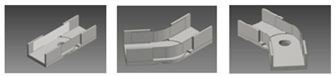

stuartlowes Posted April 8, 2014 Posted April 8, 2014 (edited) Is it possible to create an adaptive .ipt? I have been tasked with coming up with a way to show the properties of a length of sprung steel which I am hoping to show bending as two assemblies move around a center (one part being stationary and the other moving 45 degrees either side of the center) the sprung steel sheet should bend in correspondence with the rotation. (ie from straight sheet to bent sheet and back to its original form as the driven constraints turn the rotation) I have seen a tutorial on creating an adaptive spring, and I was hoping there is a way of doing what I described above. UPDATE I Believe this to be possible having discovered an adaptive flange I will keep people posted as to the usefulness to what I have found, currently cannot make this drive however im wondering if in the one I have downloaded there are factors which are not allowing my desired effect Edited April 8, 2014 by stuartlowes Quote

stuartlowes Posted April 10, 2014 Author Posted April 10, 2014 Thanks JD would your suggestions allow me to create the below mock up (mock up is very rough 5 minute job please dont be over critical) Quote
JD Mather Posted April 10, 2014 Posted April 10, 2014 Looks like 3 pictures to me. If that is what you needed, looks like you got it? Quote
stuartlowes Posted April 11, 2014 Author Posted April 11, 2014 ha thanks JD but no not as yet, had to put the issue to the side for a day or two. yes they are simply three pictures, an attempt to show you the range of motion I am trying to achieve, IF I do achieve I will put the assembly on here for you to critique/compliment as appropriate. Quote
