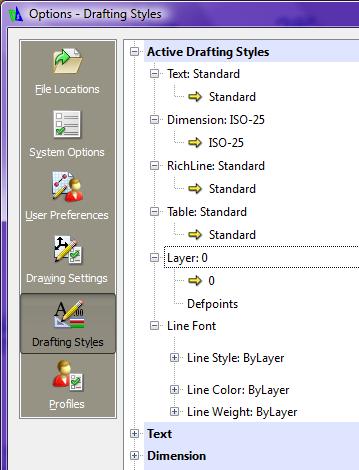

With regard to what you had written earlier, this is the choice given for the drafting styles. Layer 0 or Defpoint appears to be the only two options.
EDIT: I figured out how to add layers, but I'm still working on figuring out how to use them.

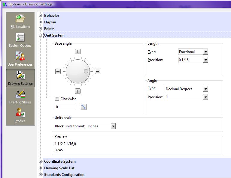

And this is where I set the units to inches.
I went through every option and didn't find another area to set global options.

You set the units to inches for blocks. Blocks are basically re-usable copies of drawing objects that you can define for later use, like windows in an office building, there may be a thousand of them, all identical. If you had built any blocks, they would have inserted into your drawing 25.4 times larger than expected.
Your dimension style was defined as fractional. They can display 25 3/4 millimeters as easily as 25 3/4 inches.

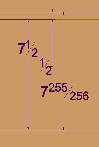

The outside rectangle on the right is caddy-womp. The top left corner is off by 1/256, which makes it 28-127/256" if you were to dimension it. But the right side is exactly 28-1/2" (28-128/256").
This is the error you're encoutering. I've attached the file.
TEST1_TZF.dwg
That is particularly weird since the right rectangle pair is a copy and paste from the left rectangle pair. After that, I still had to adjust the inside rectangles because they were not perfectly centered, but I didn't touch either rectangle's sizes.
*Shrugs* who knows. Quirky things like that can happen without warning so don't think you're alone. After a while we all learn those little quirks and know how to handle them.

I tried finding information on the offset command but gave up and just started placing things where they needed to be. This image sums up my frustration with the math.
Since I'm drawing to 256ths, once I knock the precision down to 64ths, it should all look good for me to work. Right?

The 1/256 of an inch which is driving you (and I do understand) to distraction, is way beyond the capabilities
of the stupidly accurate Incra ruler (which I absolutely love) by almost a factor of 3.
