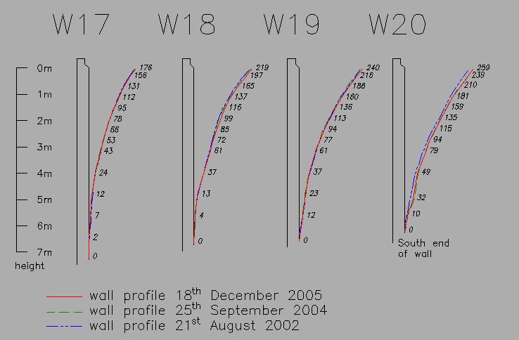

Instead of comparing surfaces, I would take the conventional approach of drawing section lines, and then you can easily compare readings from both surfaces on the same section.
When I was monitoring a retaining wall, each section was marked, so that successive readings could be directly compared.
I am afraid that it is the way of modern surveying to do a blanket survey, and then try and pick out the meaningful results. :cry:
Here is one that I did earlier. You probably have all the right data, but you have to get the presentation of the facts in a readily understood format.
Ret walls are often a problem when surveying the top can overhang the bottom and when contouring goes back to front and sometimes requires a little nudge of the points to correct.
The problem I see is if you use something like CIv3d and the vertical surface wobbles in and out then the surface in the true vertical plane will be all over the place as the algorithm used to make the triangles is based around XY position. Like you say Eldon if the wall has a lean then you can probably do very easy one profile across base and lots of cross sections with a exagerated vertical scale..
