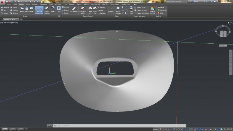

kingdaddy Posted June 4, 2014 Share Posted June 4, 2014 I have a 3-D scan Iimported and am having trouble positioning my UCS and cursor to the correctposition so that I can attach a dimension to the opening at the front of theRadome cutout. I have placed my UCSinside the cutout for reference. No matterwhat I do I cannot get my cursor to match the UCS or change the pivot point tothe tip of the nose. Any ideas or tutorialsyou can point me to? Quote Link to comment Share on other sites More sharing options...
ReMark Posted June 4, 2014 Share Posted June 4, 2014 Maybe switching to a 2Dwireframe visual style, SE isometric view and adding a line as a temporary reference will get you properly situated. Quote Link to comment Share on other sites More sharing options...
kingdaddy Posted June 5, 2014 Author Share Posted June 5, 2014 I just tried that. I was able to attach a line for both the maxhorizontal and vertical part of the opening and I can use the"Distance" command to get an accurate measurement of the opening. But I still cannot attach any linierdimensions to the opening, no matter where I snap to for starting point it willput the start point somewhere out in space not even attached to the object. Quote Link to comment Share on other sites More sharing options...

Patrick Hughes Posted June 5, 2014 Share Posted June 5, 2014 But I still cannot attach any linierdimensions to the opening, no matter where I snap to for starting point it willput the start point somewhere out in space not even attached to the object. Are you certain your UCS Z value is at the proper point on the geometry? Dimensions will be placed at Z=0 Is Dynamic UCS turned ON? Quote Link to comment Share on other sites More sharing options...
kingdaddy Posted June 5, 2014 Author Share Posted June 5, 2014 Do you mean "ucsdetect"? If so then yes it is set to 1 for active. As far as the UCS orign being set correctly I'm not sure as I am a novice at 3-D drawing, but I do have my X & Y along the vertical and horizontal axis of the opening I am trying to dim. Quote Link to comment Share on other sites More sharing options...
Patrick Hughes Posted June 5, 2014 Share Posted June 5, 2014 Looks like that turns dynamic ucs on. Try turning it off then issue the UCS >> Origin option select a point on the feature you want to dimension. I find the dynamic ucs to be somewhat cumbersome, but that's just me and my habits. Quote Link to comment Share on other sites More sharing options...

JD Mather Posted June 5, 2014 Share Posted June 5, 2014 I'm pretty sure its a 3D object with surfaces as I can mouse over a part and see a section of mesh highlite Pretty sure? What does List or Properties report. Looks to me like a very very dense cloud of points or a mesh. Probably of little use in CAD other than for visual reference. Post a screen shot of shademode 2dwireframe and from a couple of other angles. Quote Link to comment Share on other sites More sharing options...
